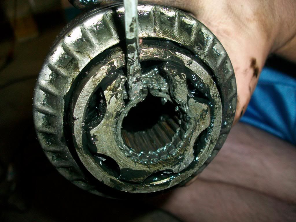

              Okay guys, spent the last 2 hours trying to get one joint apart. Im spreading the circlip but I doubt it's getting out of the groove all the way round the bottom. Any tips before I lose my mind?
              • nando
                • 34839
                Use a vice to hold the shaft while you tap on the joint.

                • A Sucked Orange
                  • 707
                  I am using a vice. Its not interested in moving.
                  Even went to the store to see if "female" circlip pliers existed, no luck though.

                    • nando
                      • 34839
                      they don't really do that around here. they'll pop it loose for free, but they won't clean it. it's not really worth paying for, once you actually get it off the shaft it's all gravy.
                      another option is to try to pull the clip out entirely. that worked for me once. also make sure you're using a heavy hammer, and hitting as straight as possible. I didn't even use a circlip plier last time, I used a flathead to spread it apart.

                      • audiquattrot
                        • May 2008
                        • 3836
                        bingo!!! thats how i did it. PITA, but i was able to hold it down on a vice, and tap out the joint when releasing the clip. Had help though. IIRC, i had a friend spread open the clip as i used a big flathead and tapped the assembly out and it broke loose. The clip came off. btw i didn't have circlip pliers. I was able to wedge flatheads/pliers in there and spread em (i forgot exactly the method). Should be easier w circlip pliers i'd imagine

                        • A Sucked Orange
                          • 707
                          Were you guys tapping on the 6 point star shaped piece in this photo?
                          • nando
                            • 34839
                            yes
