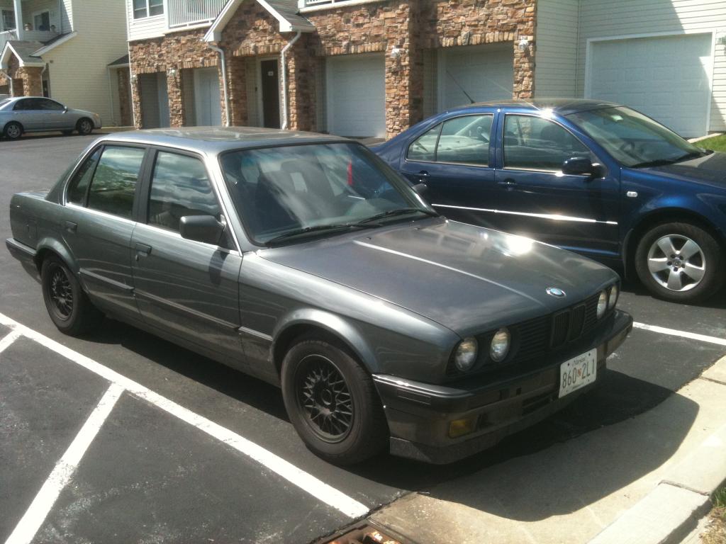

    Ok guys I need your help, I bought my '88ix last summer as winter car so not to drive the //M3 in the winter. When I bought the ix the car was slammed with H&R Race, The interior was shot, front axels where shot as well. The boots were cracked and dirt and grimed had gone into the bearings. Needless to say I felt in LOVE with this little ix, so I deceded to bring it back to BMW standards. Now it has a new sport interior, new M-Tech I steering wheel, New front axels, new Kumho ast tires, new OEM BMW head unit radio, new rear and front side markers to replaces the smoked ones it had, new suepension (oe springs w/ bilteins), new blower motor, new moon rooof motor. Next weekend its getting a new (to me) motor from a '91 ix with 108k miles and a new OEM exhaust system also from the '91 donor. That is why I want to get the springs now to do all the work at once.
    At time of purchase
    little%20one by //M3 Manny, on Flickr

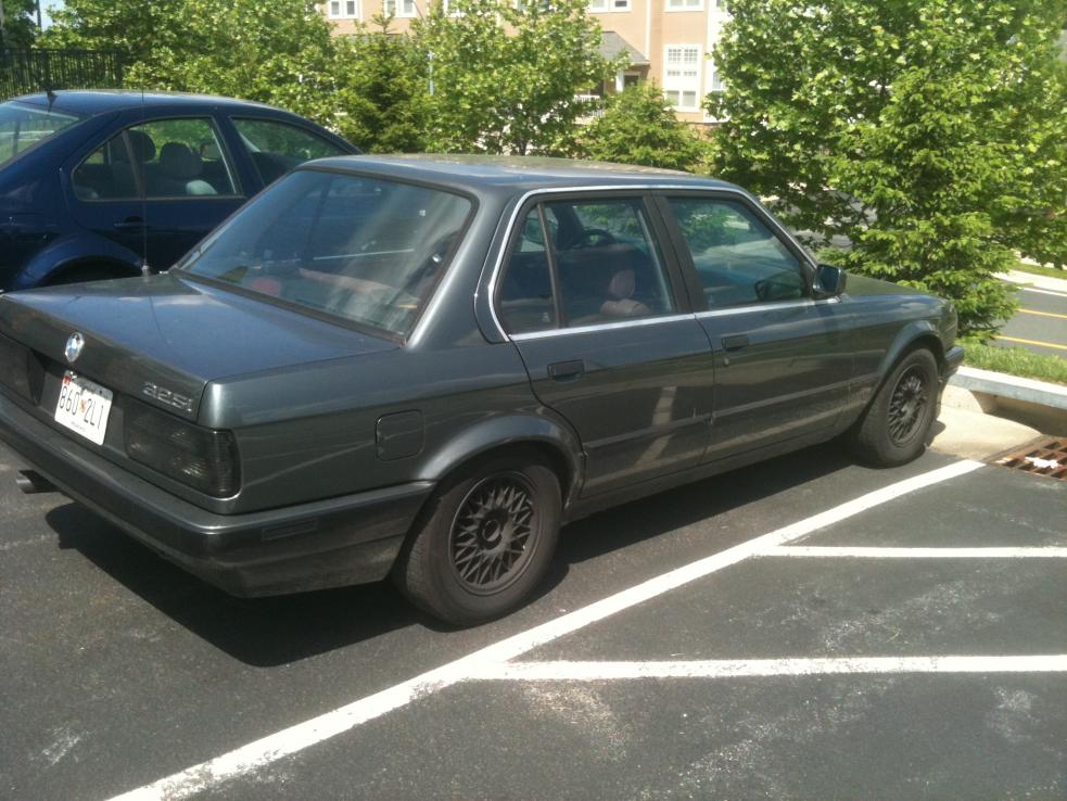

    Now (with stock springs and bilsteins shocks it seats to high)
    IMG-20110515-00043 by //M3 Manny, on Flickr
    I want to lower the car to improve handleling and the only springs that I know that are made for the ix, are the H&R Sport for ix. What do you guys think I should use
    Thanks
    Manny Rod

      Thanks, but in the 1st pic the car had the H&R race for non ix. The car was slammed it handle better than my M on the corners but the price to pay was front new axels and you know how cheap those are :jk: I think I'm gonna go ahead with H&R sport for ix and Bilsteins H/D
      Thanks man, I thought I was gonna get more help from the forum
