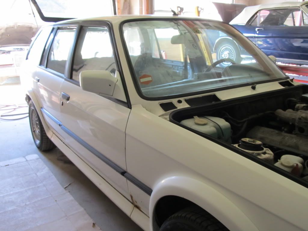

      I'm not the owner, just tinkering at a buddy's shop, the owner has 25+ old bimmers, his favorites are the e30 Ix's with 8 or 9 examples. We've done ground ups on 3 of the ix's, but this is the first touring. Among other things, this car is getting power windows from manual, adding heated seats, and he wants Euro chrome bumpers in place of the plastics. I've been taking some pictures, should be an interesting project.

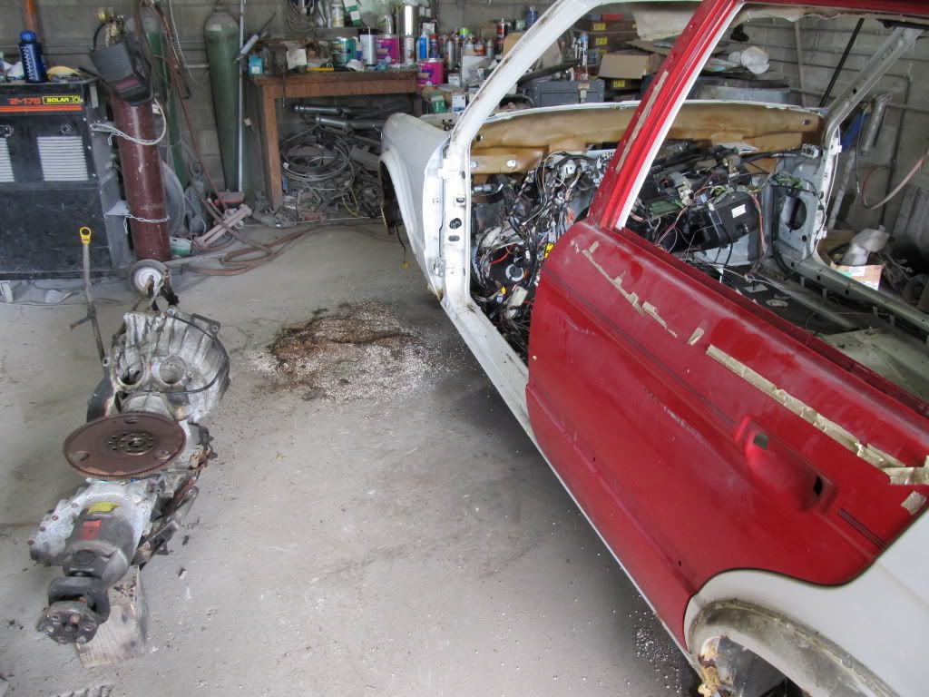

                          Update: new fuel tank, all new lines, Ebrake cables, heated seat and PW harnesses in, I'll post some more pics soon.

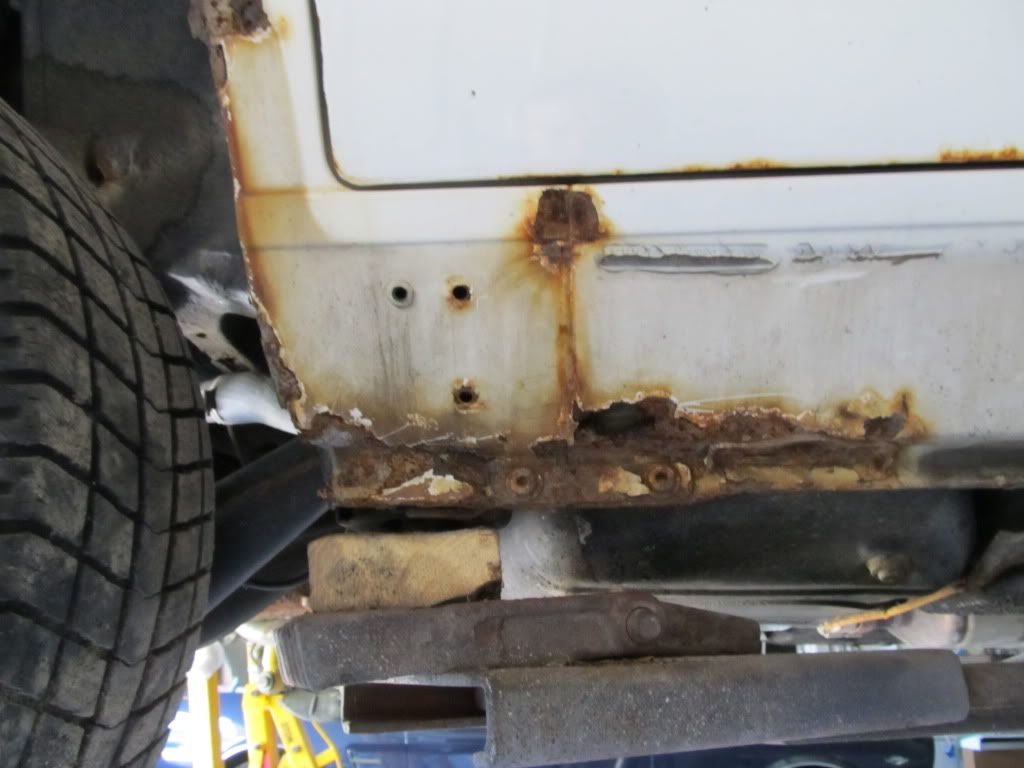

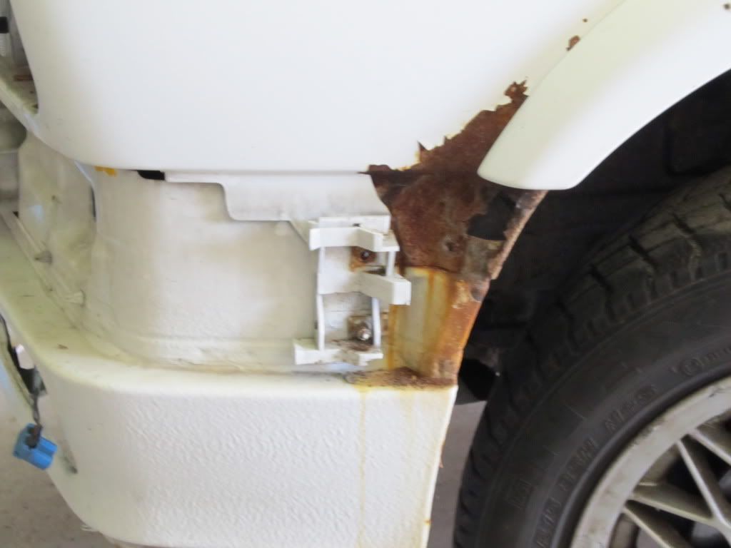

                            Tackling the worst of the rust first:

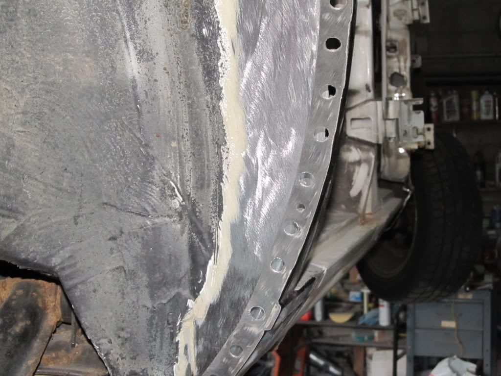

                            Car has new driveline,gas tank, fuel and brake lines, suspension, etc, time to start on the body work, fixing this gaping rocker hole tomorrow:
                            We have a relatively solid donor car that was front-ended.
