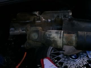

              Here is a pic of mine collapsed.

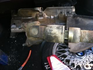

              and then extended.
                This end that is pictured attaches to the differential
