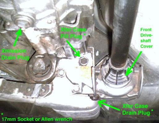

    I'm trying to change the T-case fluid and would like to see a photo indicating the locations of the drain and fill plugs. Anybody got a picture of these?

      They are in the same place on all ix's

        I think Nando might be wrong... (which is REALLY hard to believe).
        The picture above is a manual transmission transfer case. Automatics are different.
        I just changed the fluid on my automatic tonight after spending way too long looking for the plug location shown on the manual. (On the automatic, it's small, hidden by the lip, and usually covered in a thick layer of road grime). The drain plug is 17mm. The fill plug is 13mm. You'll need a universal-joint socket to get to the fill plug location, but it's possible.
        Here's a picture showing the differences.

          I didn't mean it was in the EXACT place down to the millimeter. lol. but it's in the same spot. :)
