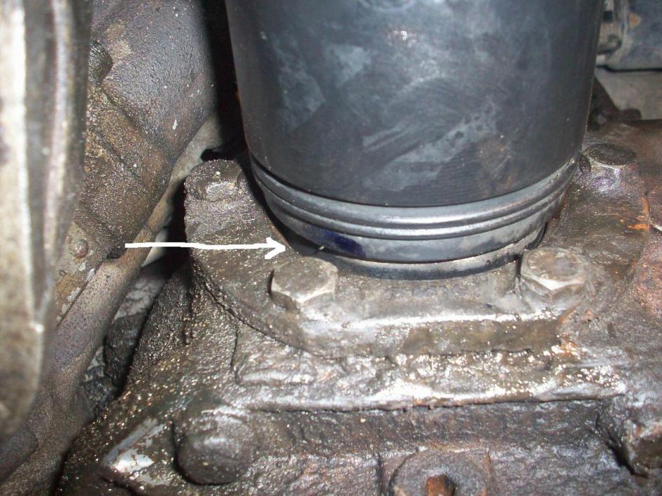

          After pulling out the axlehaft and reinstalling it.. (and measuring depth) I am sure I have it all the way in.. (see pic.. the blue line is parallel with case... I can only get a screw drive tip in if I angle it a little bit..)
          I beat on it so hard I damaged the threads somewhat.. (yes I had the nut flush.. but now it is hard to get on and off the first few threads..)
          I can get the far tire to move in opposite direction if and only if I go real real slow... but otherwise I can turn it freely without the passenger tire turning..
          I have no front driveshaft installed..
          So if I don't jack up the rear, this is normal? without a front driveshaft?

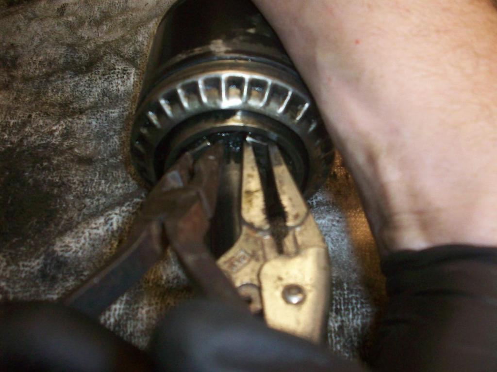

            I thought I might post this in case it helps someone else..
            Here is how we (my neighbor thought of it) got the circlip open to slide the shaft out for boot install..
            at this point just pull with you free hand and one guy can do it..

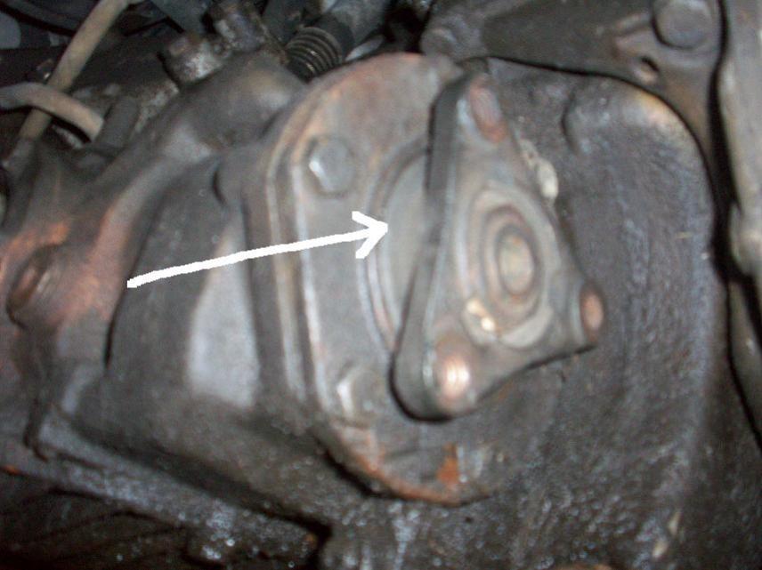

                    What I learned from another forum is that "the front diff on an iX is an open differential. (sic) and when the other tire is not spinning, the input flange is. (sic) it is normal operation. If you stop the input flange from turning, the opposite wheel should turn freely in the opposite direction"..Richardodn..
                    The opposite wheels do turn when I hold the input flange...
                    If I don't hold the input flange, I can spin one tire and the other tire does not spin but the input flange does spin.
                      that is normal.

                            Is a small gap between the CV casing (I guess that's what it's called) and the front diff normal? I just did mine and have a gap maybe 1/4 or 1/3 of an inch wide. I could turn one axle easily with both wheels off and the other axle would spin, so I figured it would be fine.

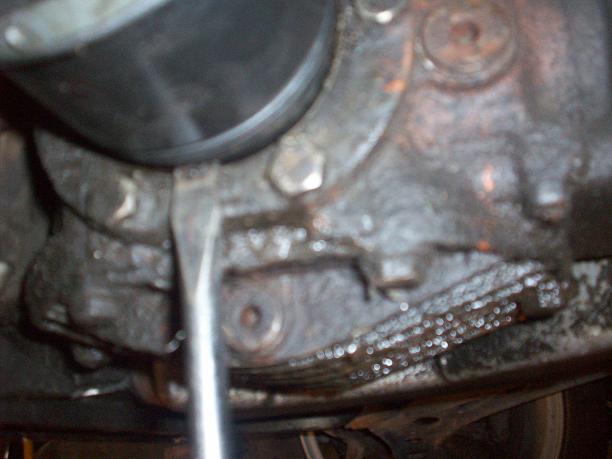

                              The following pic shows that I am able to get a large screwdriver flat head in between the axle shaft and housing. There is a little space - I would guess a 1/8 to a 1/4 inch.. depending on angle
                                Good. I put everything back together and drove it to get an alignment with it like that and was worried about it all day. Thanks, now I can relax haha
