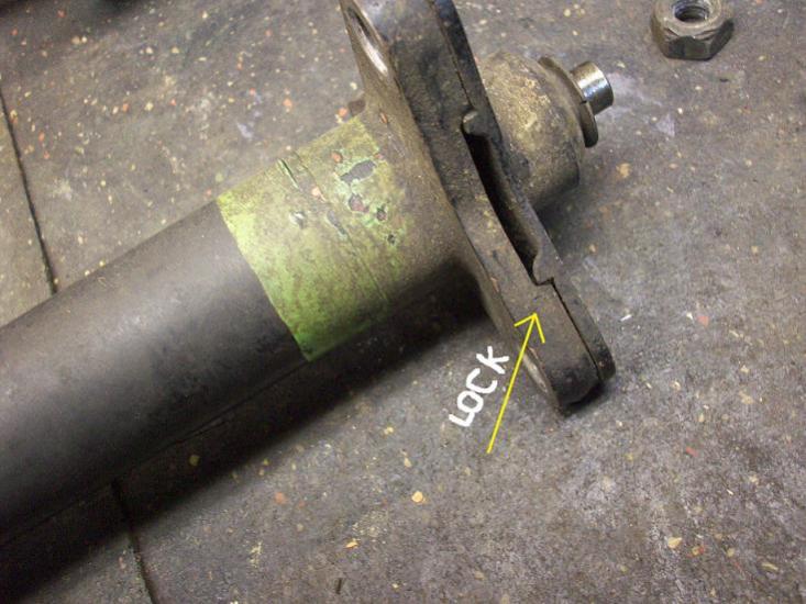

    Shimming with washers is a short term fix - however the factory centering flange (centering pin spacer for the front driveshaft) remains and relatively no vibrations are reported when driving.
    Shimming with a 1/4 plate is possible, however the centering pin spacer cannot be used - it may engage barely - however it does not "lock" into the driveshaft (see pic of driveshaft and centering pin plate contours) and vibrations have been reported...

    This seems to be preferred but again the centering pin will not reach and if used and will cause the heads of the bolts to hit the transmission case cover - which is suggested you "grind down"..
    Chris 325ix suggests that an X5 center pin may fit through the thicker rear 27mm E30 325ix guibo and be used to center the driveshaft.
    This seems to me the best way to shim the driveshaft if the X5 pin will work...
