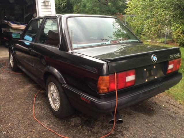

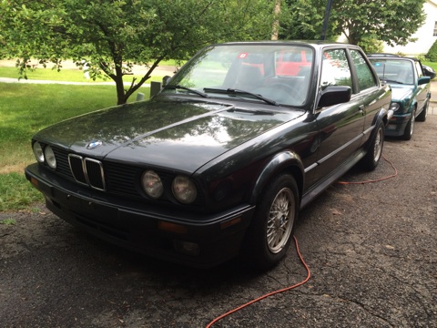

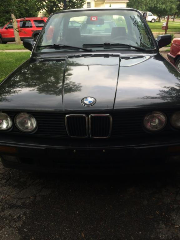

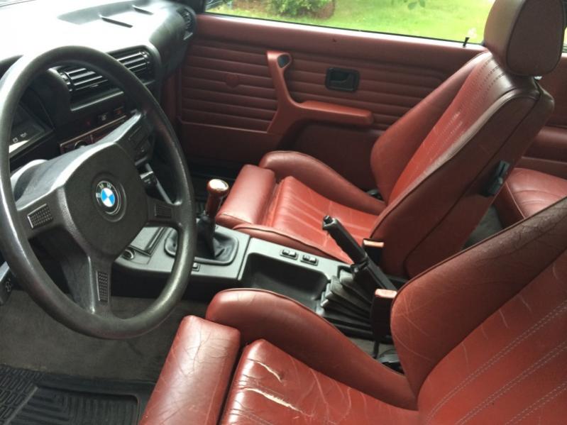

Some pictures just for the hell of it.CENTERBAR MOTORSPORT - Check out my small Bimmer/Beamer parts and custom projects business!

Also the PO told me that when with locking mech went bad on the trunk he put power to it to try and unlock it or something sketchy like that... could have just fried it... Either way it works now, throw in some brandy new injectors, get it registered and inspected, and keep an eye on it and she'll be all set.CENTERBAR MOTORSPORT - Check out my small Bimmer/Beamer parts and custom projects business!
