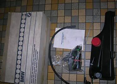

              wish i'd save the pics now
              well i have never seen it in person but did see pics from someone trying to figure out what it was about 6 months ago but dont remember which digest that was on ,i will search around a bit but dont hold your breath
              its a black plastic container with a bright orange cap that ties into the dipstick tube.

                a picture should be in the rare parts thread.
                • spdracrm3
                  • Sep 2009
                  • 959
                  found it
                  OEM Oil level Matic

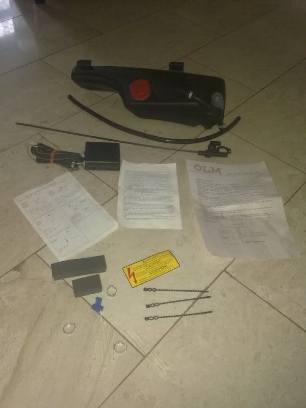

                    Originally posted by spdracrm3
                    spdracrm3 Thank You for the lead.
                    The photo's below I copied the location from two of the postings
                    From a postings dated 06-21-2010 on e30tech.com
                    http://www.e30tech.com/forum/showthread.php?t=95107
                    ...."original Oil level Matic for an E30 318i M10".....
                    This would be an interesting option / item to locate and install.
                    Joseph

                    • The Dark Side of Will
                      • Jun 2010
                      • 2796
                      Doesn't look like it would fit an IX strut tower right, and obviously wants to occupy the same space as the coolant bottle.
                      BMW was very reluctant to change their wiring harnesses.
