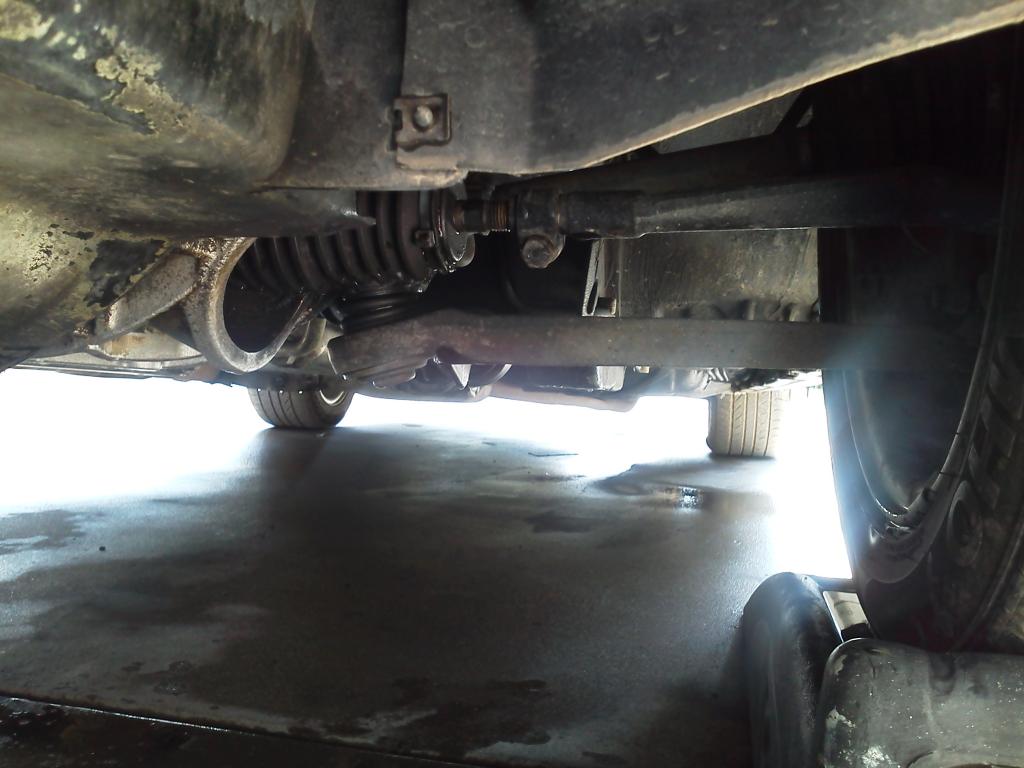

    Lowerd ix front axle pic
    Anyone have a picture from the front end where you see the front drive shaft angle? Would like to compare :)

    Hopefully this will help.
    I was changing oil on Sunday and remembered you needed a pic...
    My front ride height is 13" from the center of the wheel straight up to the fender lip.

        I need to do mine. I want to say it's 11.5-12" from the center of my wheel to the fender lip. the axle is pretty angled!

          The car definitely looks better at 12", but I was going through halfshafts every year.

                Can post a pic of mine later for comparison :)

                  Heres with the car on stands :P Bretty bad pic though..

                    Im at 13-13,5" with the car on stands :D

                      Just put it down on the ground, pretty excited!! Its been a while since haha!
                      I got 12,5" now, ridiculous angle on the drive shaft haha :P

                          Great :) I wonder if my front diff center line is the same as with the M20 :P

                            you moved the firewall back right? I bet it has to be pretty close otherwise the CV shafts would hit the subframe.

                              Yes i did, i think so too. If i pump the suspension all the way up without a spring the drive shaft just touches the frame rail if i remember correct. Something like that :) I dont think it can touch with the spring in place.
