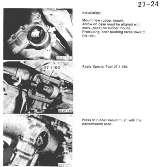

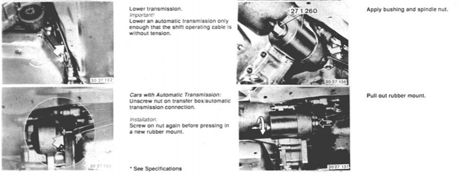

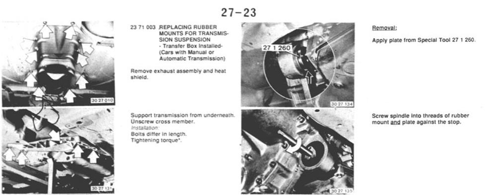

          from factory TIS
          manual,with special factory tool or equivalent

            Manual and auto use the same mount
            I usually just take it into a shop and have the new one pressed in.

              Does anyone have the special tool 27-1-260 that the service manual says is needed to change these bushings out? If so, I would like to rent it if possible. PM me if you got one!

                It looks like a ball joint kit would work to press the bushing out and in, but only if the TC is removed from the car. I was hoping to not have to do that!
