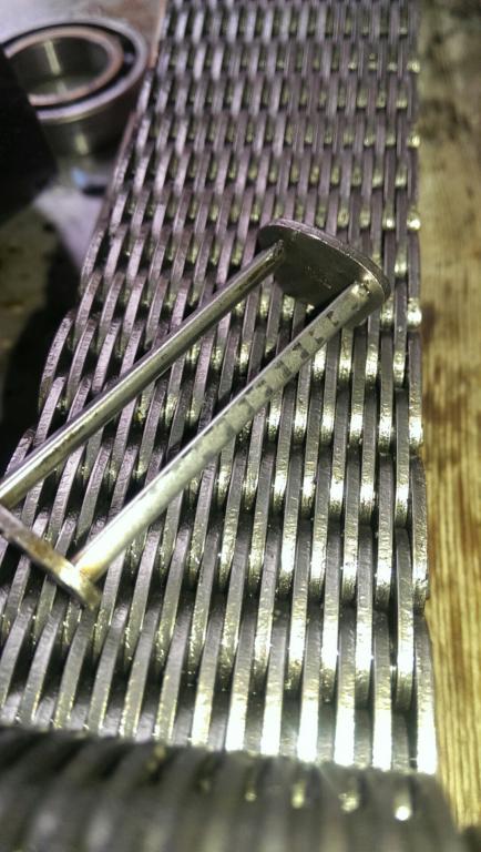

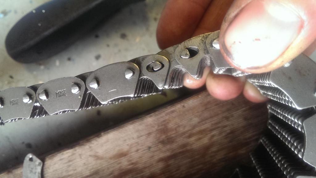

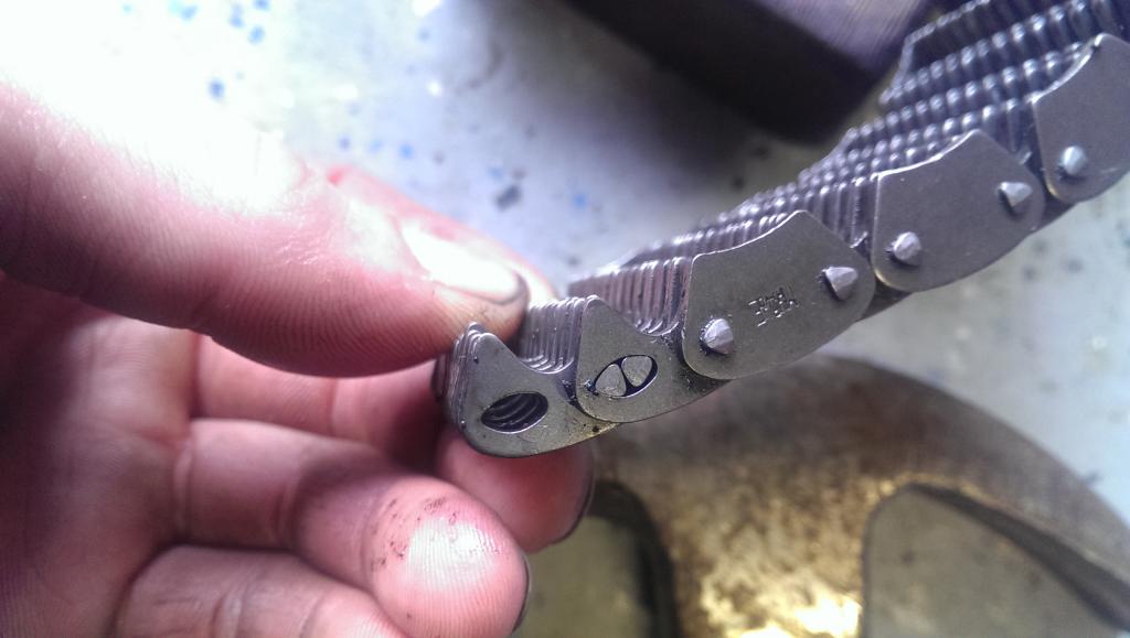

      I went ahead and broke my old stretched chain to see what was up. Looks like the blue link uses the same pins as all the rest.

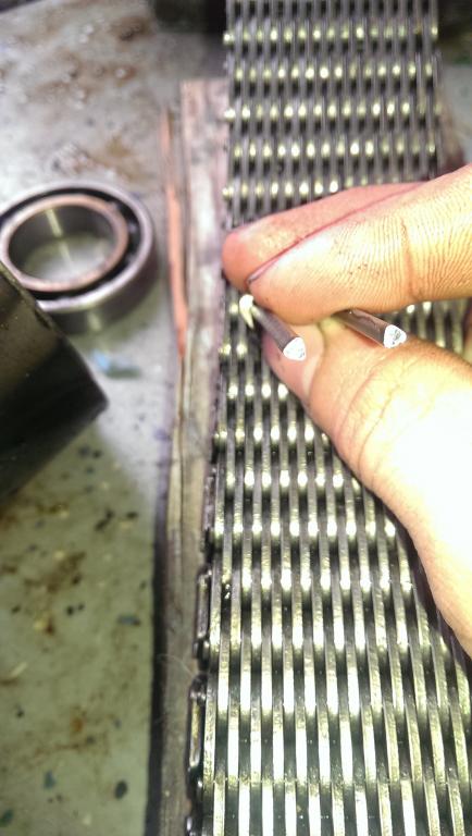

      These are the inner pins that ride between the outer plates:

      There are wider chains with the same pitch that I could source the pin from, but then I have to worry about staking them with the correct preload. What I'm thinking is use the old ground off pins with the same old plate, that way I could match the preload by eye since the pins/plate are ground flush, then TIG them back together.

        aren't they just deformed on the ends so they don't slide out?

          Yea they're basically rivets. Problem is that after I grind off the tits to break the chain there isn't any material left to re-rivet it back together.
