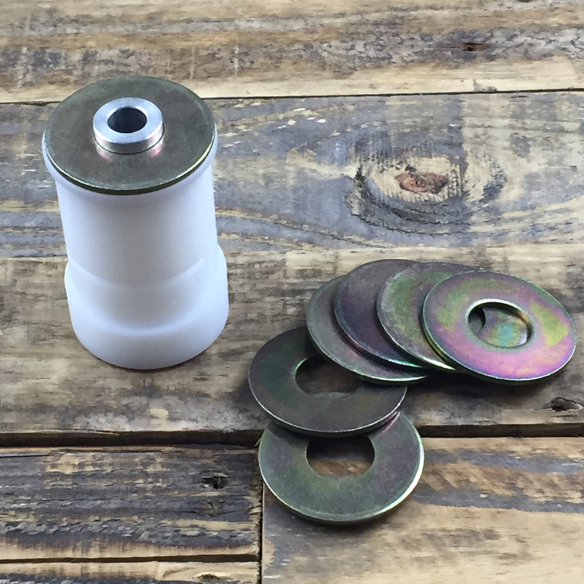

                  Do I need the rwd subframe brackets specifically, or could I just use one or two spacers/risers likes these?
                  Check out our rear subframe washer designed for the BMW E30! Shop our other BMW car accessories and BMW performance parts at Condor Speed Shop.
                  1988 325iX - sold but not forgotten
                  1984 MTech1 323i
                  • Nisse Järnet
                    • Aug 2013
                    • 1221
                    You can use spacers/washers.
