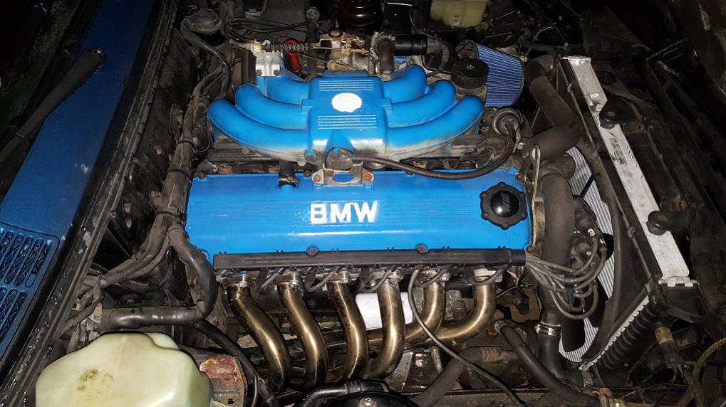

    Sooooo finally got all the exhaust bits sorted.
    I had to remove the heads completely to get the bolt machined out so I went ahead and replaced all bolts, gaskets and even the timing belt while I was there. What a PITA!!!
    But she is up and running. Having a little problem with the coolant system circulating properly but I think the worst is over....for now lol!

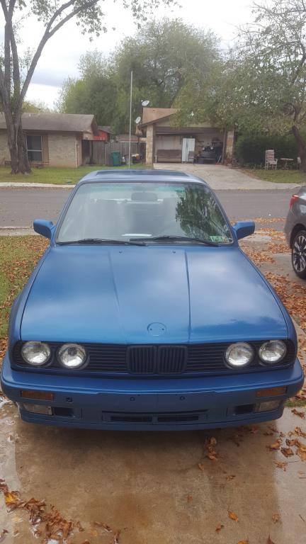

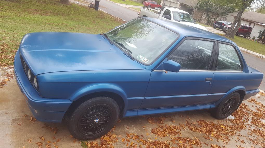

      • flyboyx
        • 8371
        The coolant circ. Problem is likely air. Did you unscrew the bleeder on the thermostat housing? What type of paint did you have sprayed on the car?
        Gigitty Gigitty!!!!
        • ACVC325ix
          • Dec 2016
          • 123
          ahhhh that makes sense, I will bleed the system again this weekend. Thanks!
          Its actually slate blue plastidip lol.
          The diamond Schwartz was in terrible shape and I want to restore it someday but just don't have the funds ATM!
