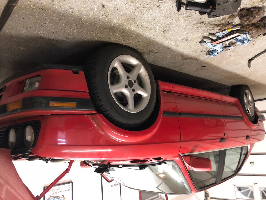

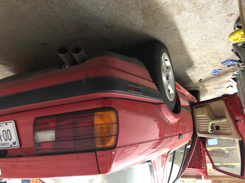

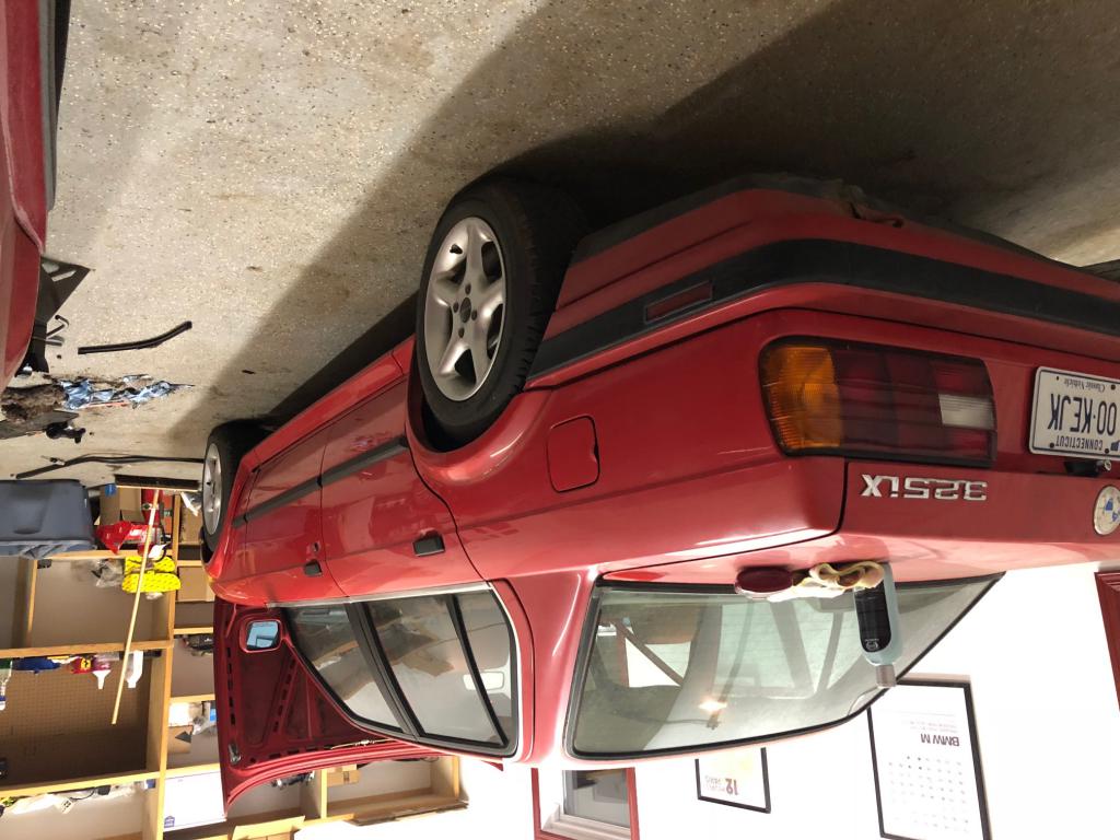

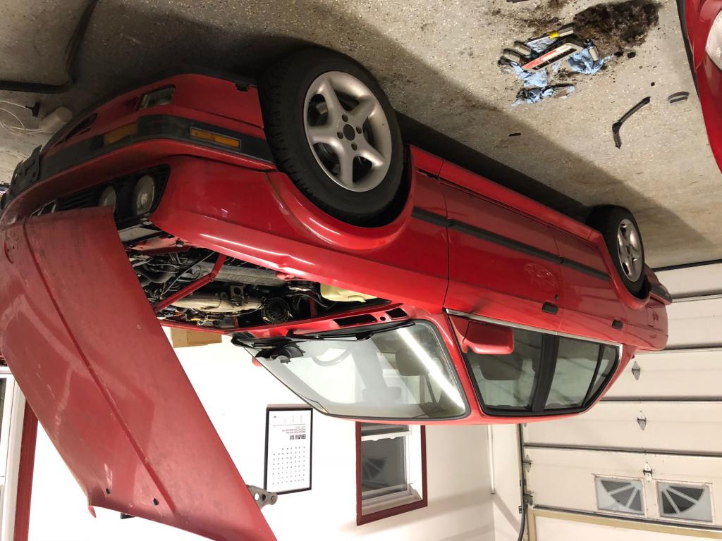

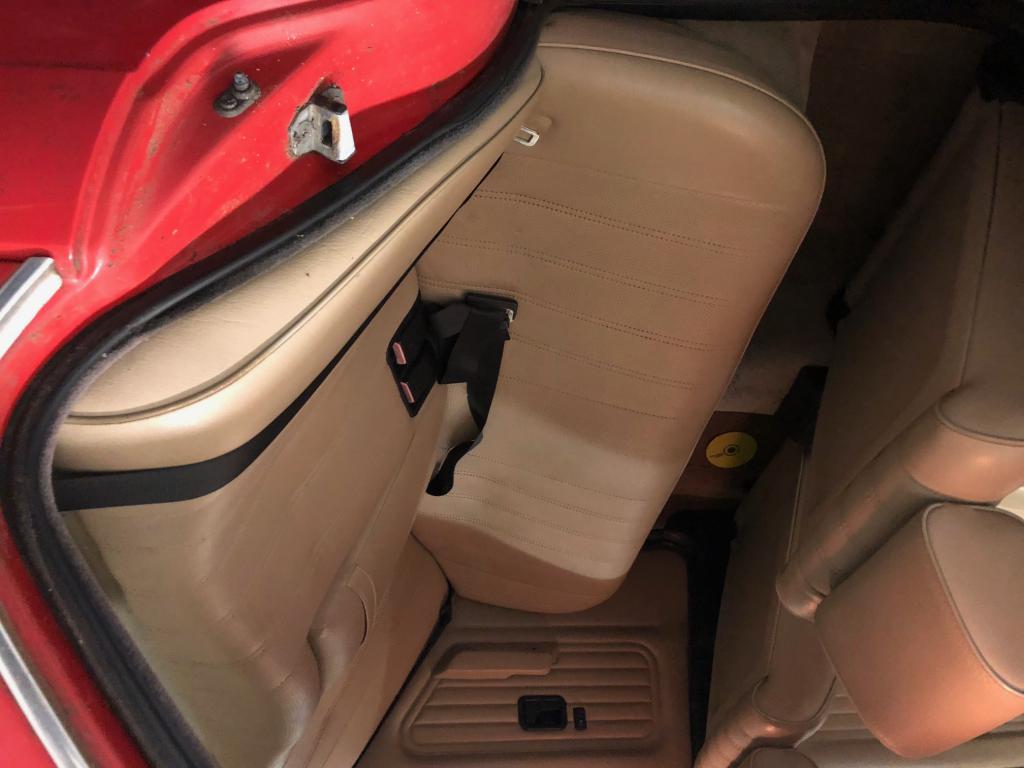

                            Photos
                            Pics attached. Hasn't been washed since sitting outside for 2 years. She's about to live the good life in a 6 car garage!

                            • The Dark Side of Will
                              • Jun 2010
                              • 2796
                              No wonder you can fit six cars! You can stash some on the ceiling!
