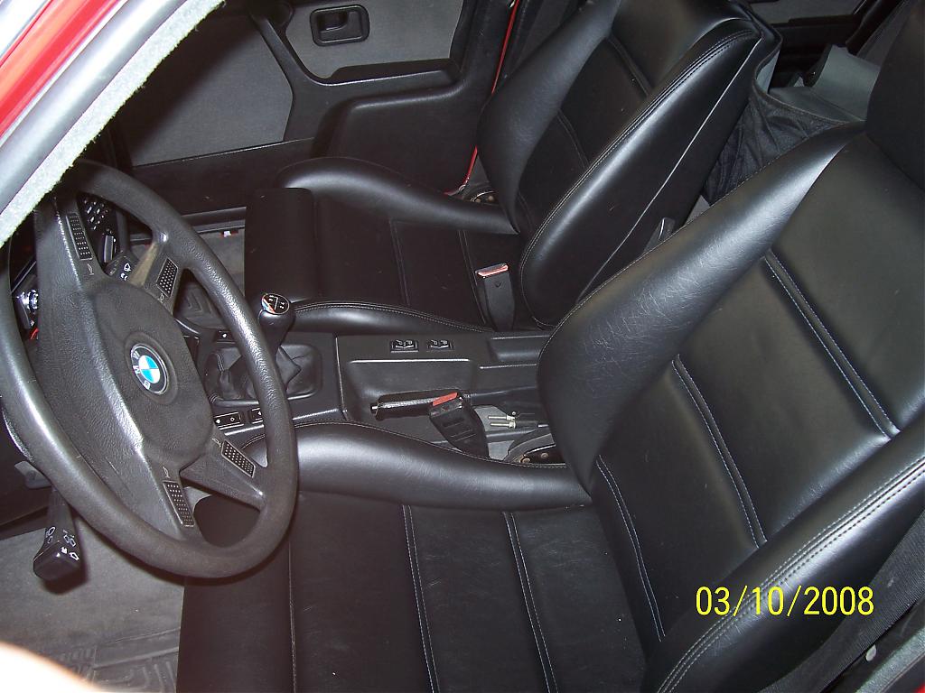

                Here is a pic of the new heated seats, I love them BTW. If you meant pics of the bent bar I could get that later if you need. That cover in the back is for my dog in case you were wondering. I just wish i could find an M-tech II steering wheel to fiish it up, but I dont feel like draining my back account now

                  I just wanted to see the seats. They look beautiful, I like!

                    damn those are nice - did you have them recovered or did you buy them like that? mine are in horrible shape. :(

                      thanks guys, they are cabby seats recovered with leatherette. They smelled funny at first but that is gone now, but they look pretty good IMO compared to leather(that is what i origonally wanted) but I think it might hold up better. Next is rear head rests and recover the rear. I was also wondering if it would be possible to heat the rear seats. If I could only keep my dog from shedding. Any ideas on that?:D
