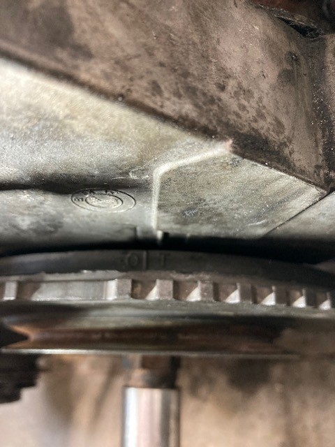

    Hey Guys!
    First time doing an e30 timing belt. This is on my new to me 88ix.
    i seem to lose the crankshaft timing slightly when I install the belt. Prior to installing the belt the crankshaft timing marks are dead even, after the belt as you can see in the pics, it is slightly off. Is this acceptable or do the marks need to be dead even? If so, any thoughts on why I’m losing the timing while installing the belt??
    Pics make the timing marks look a little closer than they are guys....

    I was able to rotate the pics....gives you a much better view. Click image for larger version

      Turn the crank clockwise to get rid of slack, line up the marks there and then look at the cam marks. It is hard to see the cam marks due to the camera angle.
