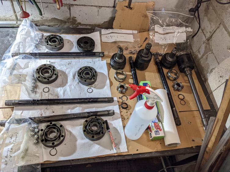

                        Just so that I understand, can you tell me which parts you need in terms of rebuilding? Do you mean the ball bearings, and cages etc.?
                        Click image for larger version  Name:	PXL_20210309_154352199.jpg Views:	0 Size:	81.4 KB ID:	10014504
                        Ignore the rear CVs (the front stuff is on the right)

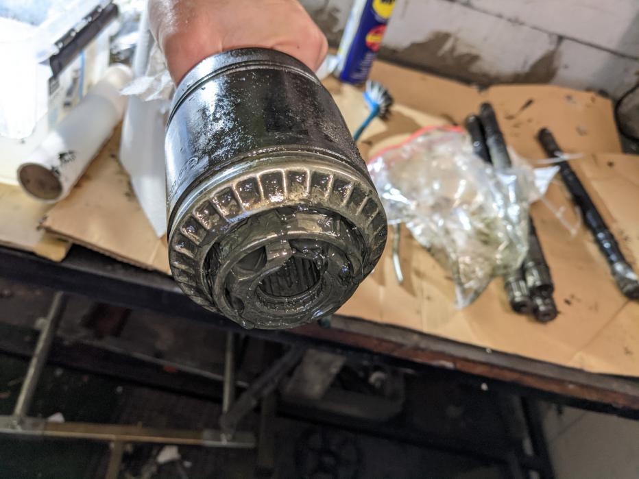

                        I am however having trouble removing the CV parts from the inner joint on each axle. The machined lip seems to make it impossible to get the balls out. Am I missing something?
                        Click image for larger version  Name:	PXL_20210318_144313320(1).jpg Views:	0 Size:	74.9 KB ID:	10014507
                        Sorry not trying to thread-jack here, just trying to understand what people need. I'm trying to find a company in Germany that can manufacture either complete axles or individual joints.

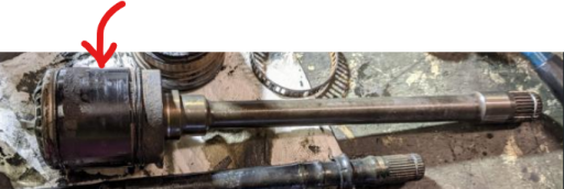

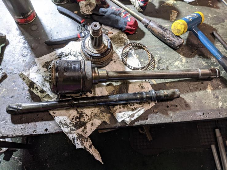

                          Hey everyone thanks for the feedback on the axles. I visited a local junkyard that specializes in BMW parts this weekend. The guy had several iX parts and I also confirmed only Lobro on the front axle shafts. I'm going to see about picking up another set of axles from the junkyard and cleaning them up to send to the axle manufacturer for inspection. Or possibly sending my backup set.
                          Big Will I think what we need is someone to make the long intermediate shaft with the joint integrated for the right side. This is the long part that shoots through the oil pan. I suspect this is the part that kills almost any aftermarket company or specialty manufacturer from making new parts. My current guess is that that whole portion of the shaft (in photo below snipped from your first photo) is forged from one piece then machined/hardened. Perhaps someone has more experience with CV joint design and can chime in. If the tripod joint/cups wears out on this component there isn't much that rebuilders can do about it (red arrow). The good news is that apparently the E30-era joints are quite hardy compared to newer 3-series shafts. See what John from CVJ axles said about rebuilds recently when I asked about rebuilds.

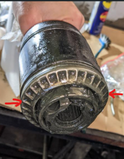

                          As for the removal of the bearings from the plunge joint, I think the lighter colored end piece is what is keeping it inside. I think this is pressed on then crimped but this is pure speculation.

                            That's why I'm saying - wouldn't it be easier to just get new CV joint parts made instead of the whole shaft? I really doubt many of the shafts themselves fail, and reproducing it from scratch is probably insanely expensive. IIRC, it's typically the cages that crack? I haven't opened up one of my bad ones to see, but it sounded awful last time I ran it.

                              I think you are spot on here. I come from the Volvo scene originally and don't remember seeing CV axles that had this additional section that both inner joints have so I'm not sure yet how to deal with it. Perhaps a special tool exists if you're an axle rebuilder that can bend out the edge? But I agree with Nando that the easier solution would be if the individual joints were available.
