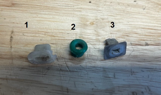

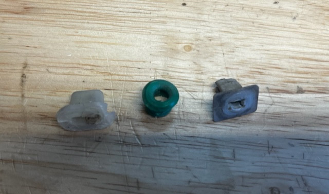

      Here's a pic of the three different pieces used to button it all back up. I only have a couple good examples of each.

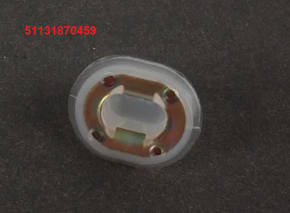

          Look again on Real OEM and find the exterior/grill section numbers 5 and 15 should get you the last 2 in your picture and the first one should be #51131870459 which is also used on the side rear window trim but verify before ordering. Hope this helps
          • E30Bastard
            Shimmy Shimmy Ya
            • Nov 2018
            • 245
            Thank You!! Appreciate the response. Just for thread clarity here is the link: https://www.realoem.com/bmw/enUS/sho...diagId=51_0721
            RealOEM 51131840154 is part number 1 (see attached pic)
            RealOEM 51711932996 is part number 2 (see attached pic)
            Part number 3 remains a mystery as it does not resemble 51131870459 (ref pic also attached)

              Is number 3 for the fog lights? if so,
              63171367868
              • E30Bastard
                Shimmy Shimmy Ya
                • Nov 2018
                • 245
                Woohoo! Nailed it! Thanks!! Case closed!
                Just a heads up - for anyone requiring the entire kit & kaboodle, you will also need these two parts and the screws associated with them:
                46637651465
                07129904224
                Body nuts/metal clips. Link for RealOEM attached:
                https://www.realoem.com/bmw/enUS/sho...diagId=41_0134
                That should wrap up everything you need to get a valance back on in factory finish.​
