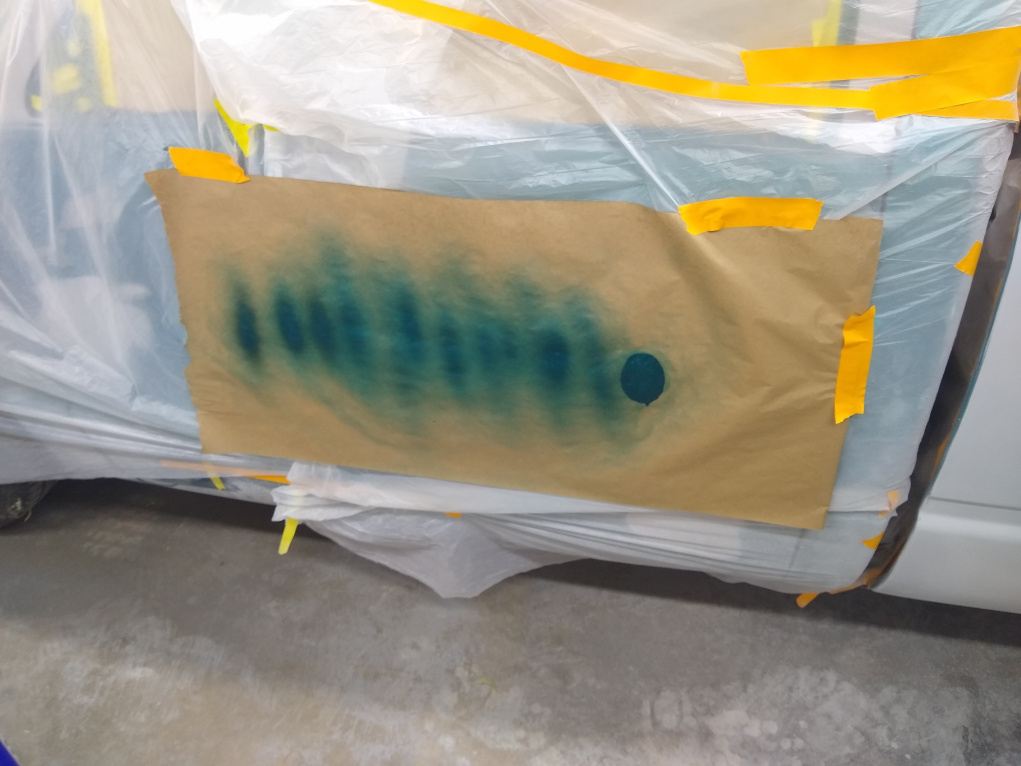

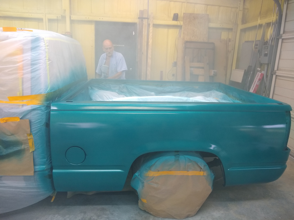

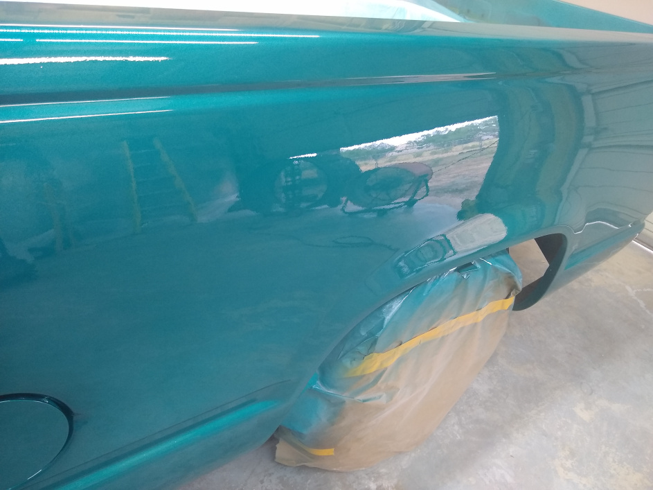

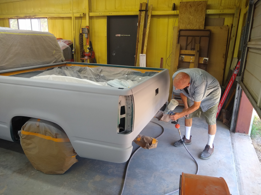

    I have painted one car with the help of a guy with 40 years of body shop experience. He used a cheap gun (HoboFreight I think), but knew what he was doing. We sprayed it in my shop early in the morning when the wind was still and used a big fan to draw air out of the building. No filters, just window screen. We did not buff the paint. There were small bits of debris in it, but could be buffed out. It was a driver paint job, not a show stopper. Turned out pretty good for $1000 in paint and materials. I plan to do an e34 next, but using a paint booth at spray time.

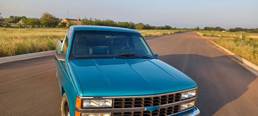

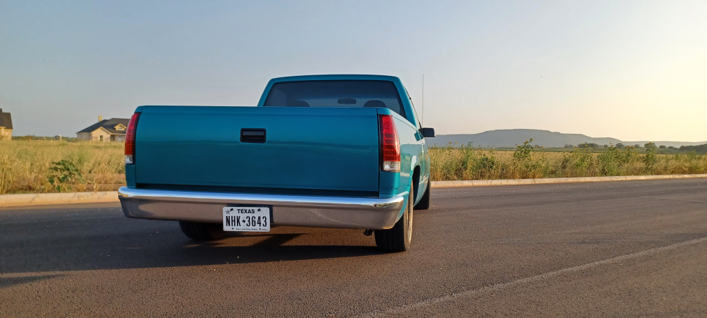

      And the final product. A few chips on the hood that were eventually touched up.

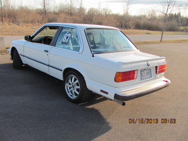

          Thanks for all the feedback and pictures
          I appreciate your time and effort
          Its a hard job but I think its worth it.
          When I wrecked my e30 track car at Watkins Glen 10 years ago I did a lot of work getting it back into shape.
          My son shot the primer and single stage finish coat and it came so nice I got compliments on it when I took it back to many more track schools.
          See attached circa 2013 when I sold the car
