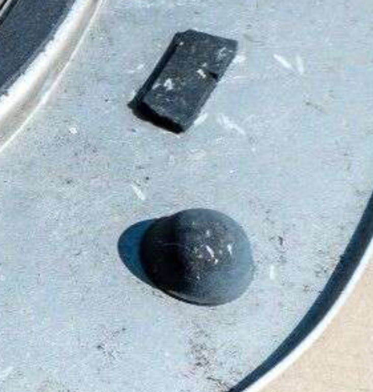

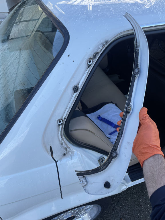

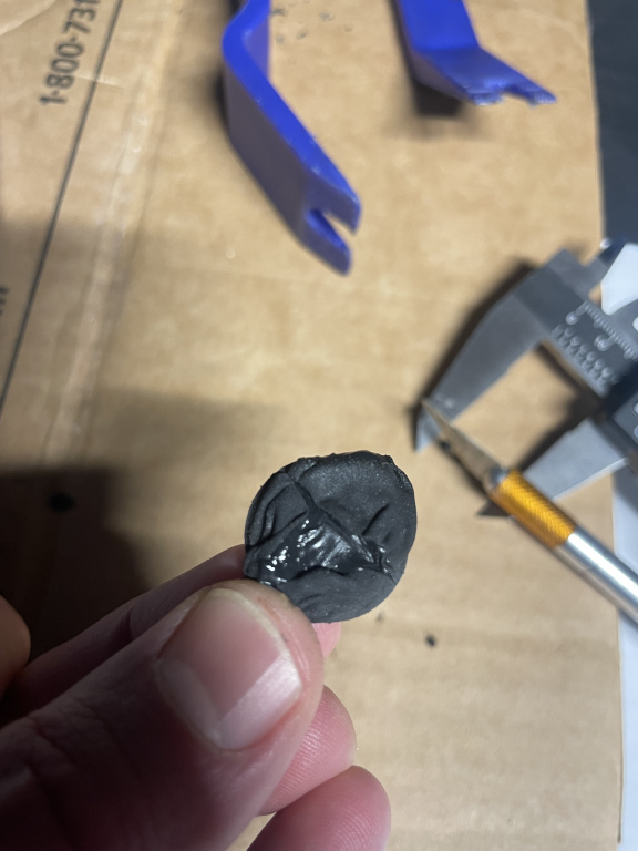

    Looking for a suitable replacement for rubber bumper on the inside of E30 sedan rear window air outlet molding (51131922331 and 51131922332). Mine manged to degrade/melt/rupture(?) in my hot garage over the course of past 2 years.
    “good” example from web search on molding part
    number:
    Click image for larger version  Name:	IMG_7596.jpg Views:	0 Size:	164.4 KB ID:	10153693
    My melted mess:
    Click image for larger version  Name:	IMG_7593.jpg Views:	0 Size:	171.1 KB ID:	10153694 Click image for larger version
    Are they some sort of fluid-filled bladder that popped? Or is a a rubber of some sort that simply degrades over time? It appears as if it were a butyl-filled rubber blister, sort of like a gusher candy.
    want to make sure trim sits properly and doesn’t rattle on the freeway once I reinstall - 51131870459​ clips and 51131904479​ are proving expensive enough to not want to have to break/replace multiple times.

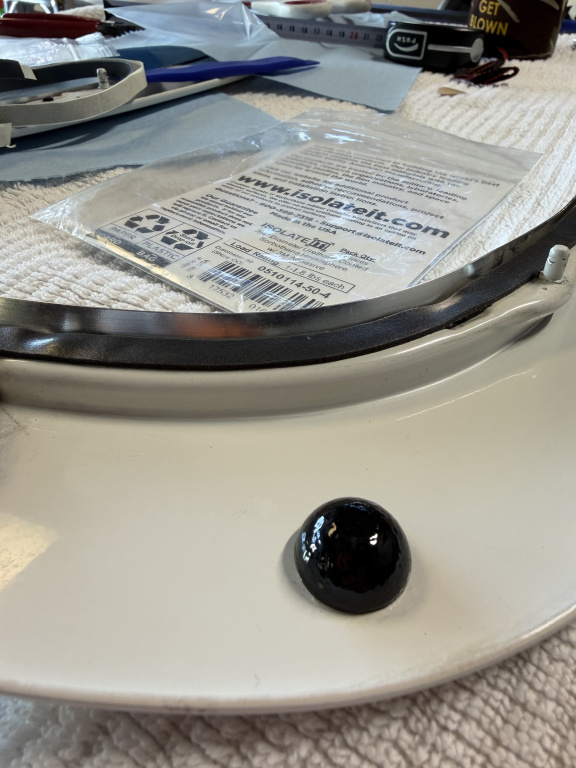

      May need to go the weatherstripping route, I discussed with Bumper Specialties & Sorbothane - hard to find something that's low durometer and outdoor friendly - going to buy some samples but not finding anything great. Probably going to look at an automotive-grade product (likely from 3M) if I go the adhesive-backed foam route, learning that a high-quality acrylic adhesive is likely what I'm looking for.

          yes that looks like a good option for material, but not thick enough - looks like the old ones are about 9mm "tall" uncompressed. I've ordered Sorbothane 0510134-30-10 & 0510134-50-10, we'll see if either of those ends up being the right fit of durometer and size. A little worried about swelling when wet, but got the urethane coated ones to hopefully help with water resistance.

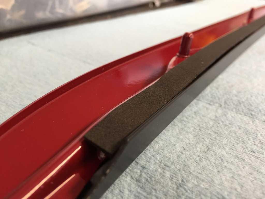

            Here's what an expert used. Neoprene foam.

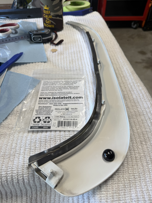

              Alright, here’s how it turned out. OEM foam, OEM clips and seals (looks like you can find cheap replicas from a few shops though), and the IsolateIT durometer 50 Shore OO sorbothane bumpers.
              Will update in another 36 years to see how it holds up…
              P.S. SEM Specialty Gel Adhesive Remover worked wonders getting off the dried up original foam and PSA.
