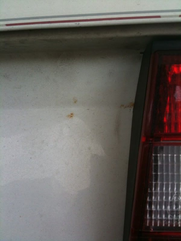

surface rust
    surface rust
    short of sanding/priming/ painting. how do just stop the rust from spreading?

    wire brush it and keep it as small as possible. brush on some self etch primer. just get some in a can and spray it in something. wait till it dries a little and gets a little thicker. brush it on. then brush on some white paint. keeping it as small as possibly is a big deal. put duct tape around it so you don't hit any other areas. you could also use some 36 grit very carefully.
