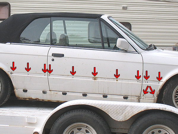

          • CRAIG2
            • Oct 2011
            • 28
            Just pulled an M-Tech II kit.....here are the holes. Left the bottom row of clips on the car.
            (Decided to revive this forum posting rather than start a new one)
            • bernzpeed
              • 3917
              you can install the same amount of clips on the door mouldings to cover the holes on the side. but the one on the fender must be patched in.
