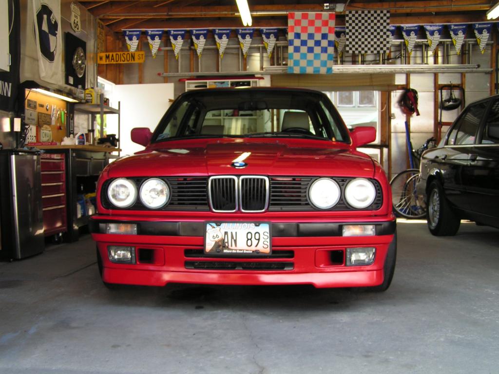

                  Looks like it came out good, nice work. I did the same thing on my car but went to a local body shop supplier and had them put together primer, hardener and Du Pont paint kit and borrowed a friend's SATA paint gun and shot it all in my backyard. No clearcoat on the non-metallic colors. It looks a lot better and will get me by until I get the whole car resprayed.
