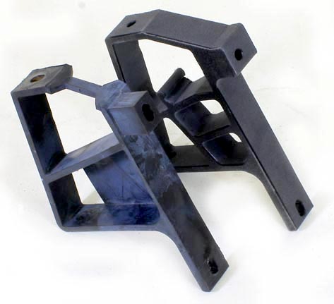

    I just purchased from a 1987 325is the front air dam and was looking for part numbers for the brackets or pictures so that I have somewhere to start in getting it to fit on my 1985 325e. I have included a few pictures below so you can see what I have and what brackets I already have. These brackets are more intact, but they all appear different, thats why I am asking for help. Thanks!

      Which one does it look like, if any?
      Also there are two other brackets / pictures I didn't include, but they just look like broken versions of the plastic center one.
        If you have diving boards, its possible to just drill holes underneath and bolt it right on through the top lip of the valence. I did it on my 87 325is a while back and it looked great, no sag and the valence held up great without any cracks. about 5 bolts did the trick, evenly supported.
        I also remember the guy who was producing those brackets, afraid I cant help where to find them though.
          I found the guy that reproduced the 3 brackets in metal, but he didn't have any in stock and didn't plan to make more. There are distinct left, center, and right brackets, the flatter end brackets, and the long flat metal bar that runs along the top.

                      Brackets for 325es and 325is E30 air dam
                      I saw the posts looking for brackets. I am in the middle of a project to produce them.
                      The original parts had a thinned out area which seems to be a "Break away" weak spot. I am looking for opinions: should I eliminate the weak spot or not?
                      The image on the right is an original and on the left a new one that I made.

                          They are in production with improvements over the ones in the picture.
                          I have added a spring shape instead of the break away thin section.
                          They will be ready to ship in 2 weeks
