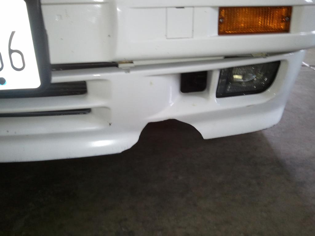

    I bought a 1991 325i M-Tech with a broken lower valance. Any ideas on how I can fix this myself or where I can get a replace valance? Thanks.

    What's broken on it. Post some pictures

      Tried to post pics and can't figure it out.
        ok posted pic
          Ah man that hurts to see. You may be able to have it fiberglass repaired. Otherwise check bavauto.com, ebay, and the for sale section for a replacement.
            Depends on what kind of plastic it is.
            If you had the missing part it would be easier, but you can probably fill it with the proper material mixed with some chopped up fiberglass mat. Clean it well with solvent on the back, & scuff it well with 40 grit paper. Cover the front with 2" masking paper to hold it while it dries. Then come back to the front & sand/fill until it's smooth.
            Perhaps JB Weld will stick...
