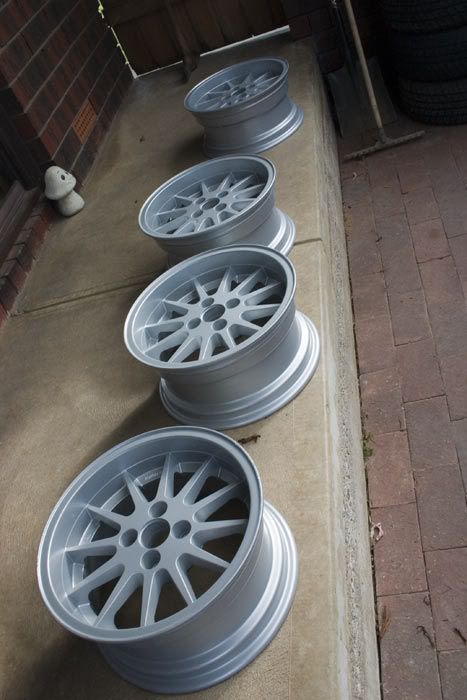

                          I recently had my wheels powder coated.
                          Didn't cost me anything because my neigbour is mates with a powder coater.
                          here's a pic.. I'll post one of them on the car once the car is back on the road.

                            That finish kind of looks like a matte primer...? Awesome rims though.

                              It's a shiny silver colour same as when they first came out.
                              I could have got them polished and I think it may have looked better but considering it was free I just went back to the original colour.
