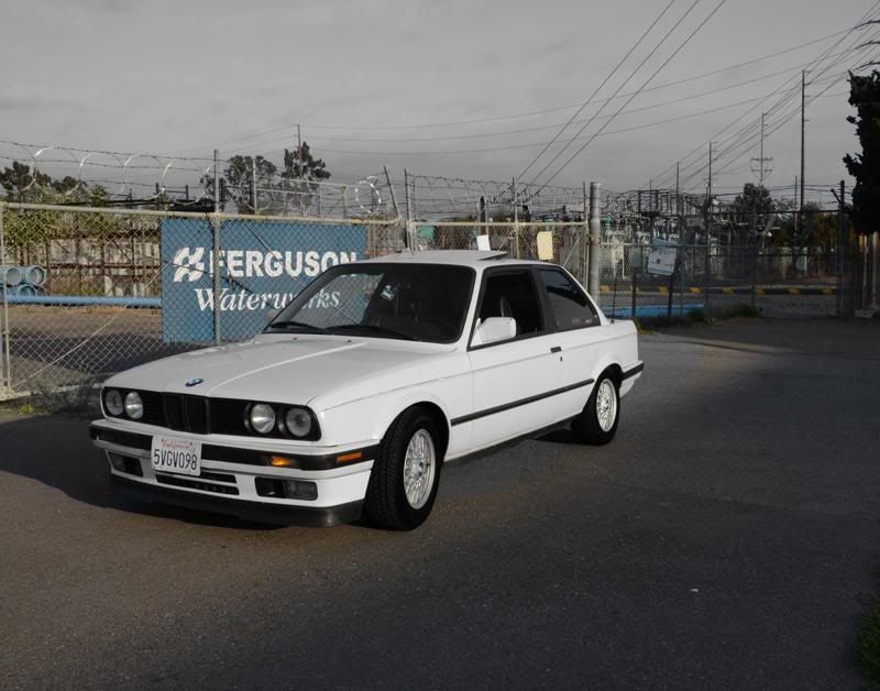

    First thread updated with final pics.
    • acolella76
      • 2950
      It is a little off.. but with the bumper there to sort of break the two pieces up, you can't even tell. I think for small stuff like mirrors, valances, etc. that is good enough.
