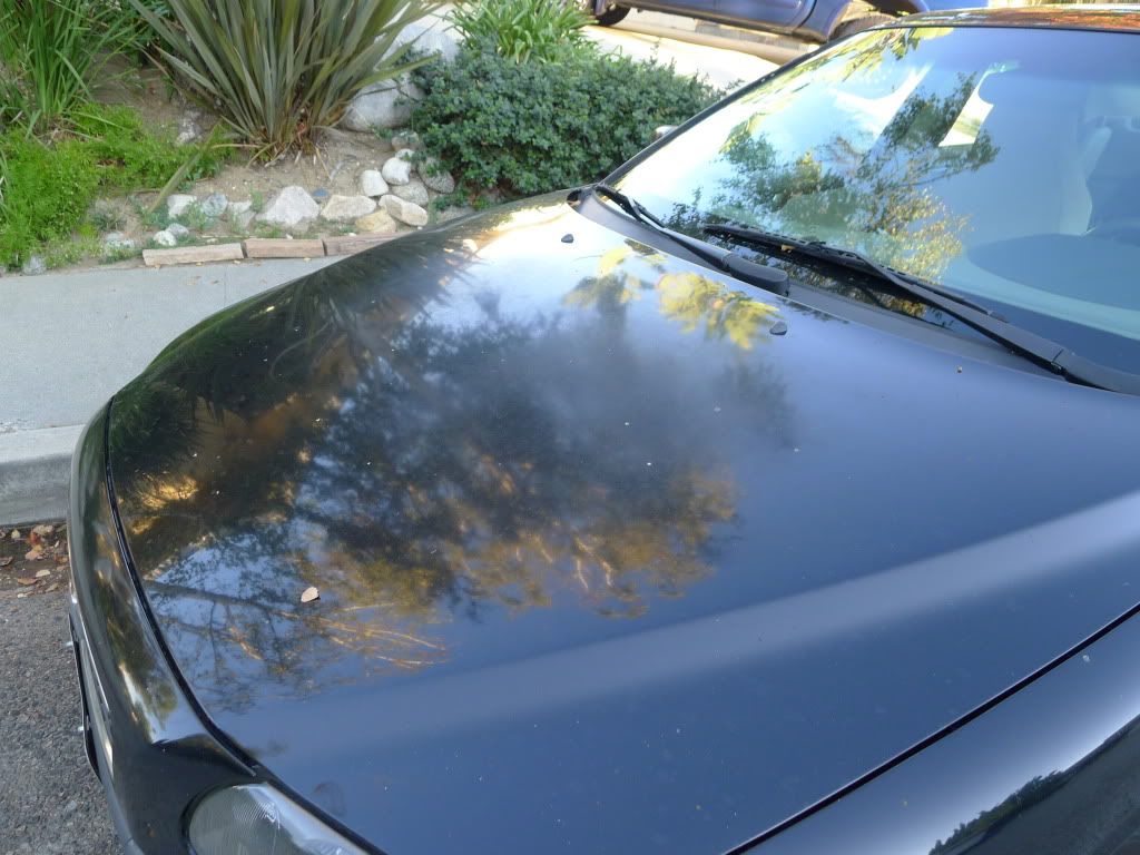

    Oxidation?
    Is there any cure for this kind of oxidation?

    if it's single stage, a high speed orbital will take it right out for sure. if it has a clearcoat, it depends on how deep it is.
    a detailing/body shop should be able to tell you.

      Uh...it's a factory paint job on a 2001 Volvo s60.

        rubbing compound, orbital polisher, polish compound, a few hours and you are good to go...

                  Lol wtf OP? Calm down and people will be more likely to help you. I'm a detailer and i'll tell you this much:
                  The hood is definitely fixable, it will need to be compounded and polished, or maybe even just polished on a buffer. You can do this by hand. Go to kragen, buy a tub (it'll be a tub, not bottle) of rubbing compound, a bottle of swirl remover, and wax. Follow the directions and do it in that order.

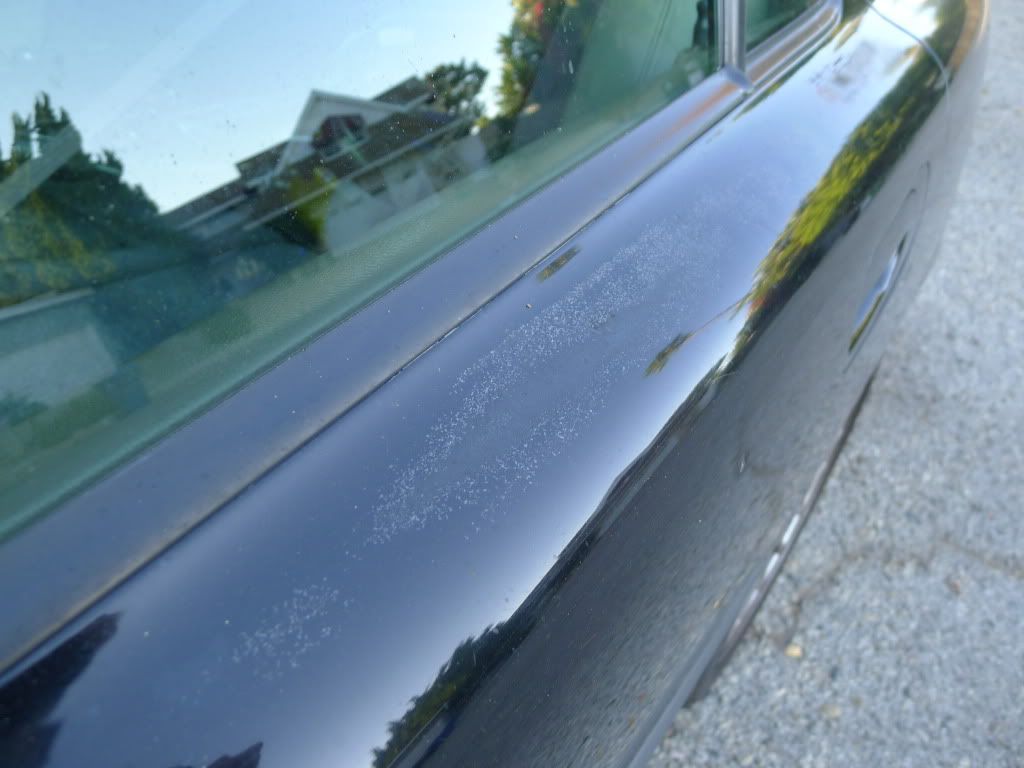

                  For the side, if it's bubbling, you're basically fucked. You'll have to strip it off and spray new clear coat on it. Go to a bodyshop for this and they'll probably polish your hood for free. If it's not bubbling, repeat what you did on the hood. Since it's really not an old car, it seems like crappy paint, so make sure you always keep it waxed (re-apply every 3 months for an average cheap wax)/
