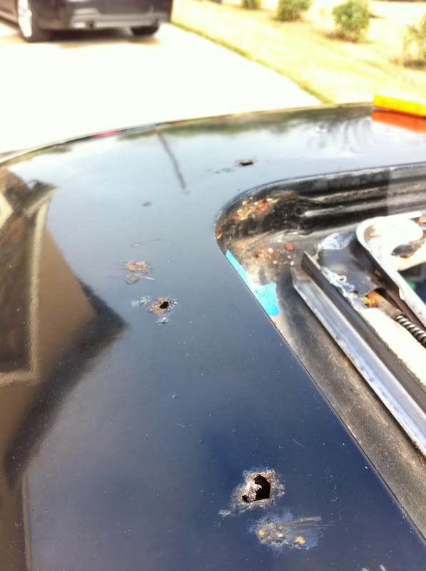

    I did and here's what I found when I was replacing my door seals
    I first poked with a screw driver underneath and caused these:

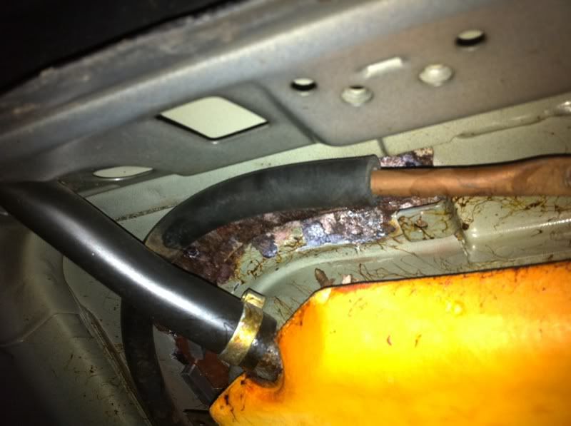

    Here's what it looks like under there:

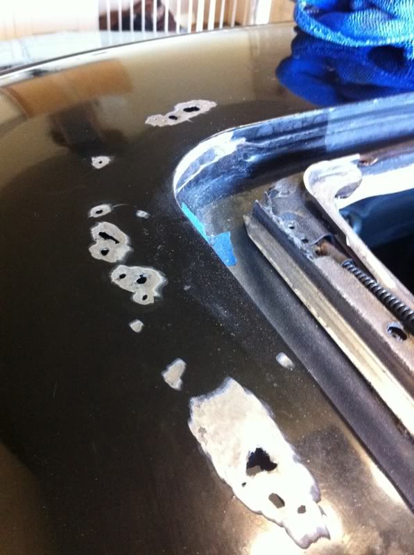

    And after some grinding and more poking:
    So yeah.......

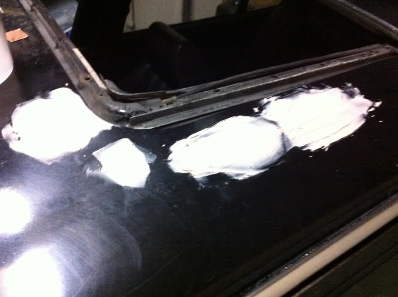

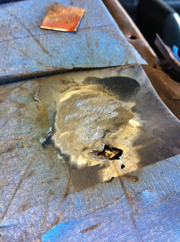

    My local Fastenal happens to carry some 3M Ultrapro Seam Sealer. It's primary usage? Water proofing automotive panel seams. :)
    Given it's $30 for a little tube, but I need it for this repair to be successful.
    Also repair #1 in the sunroof rain channel didn't take well (see pic #1) so I'll be fixing that as well now that I'll have some real sealant.

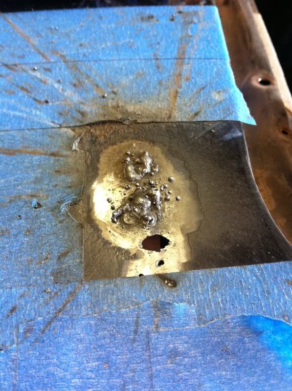

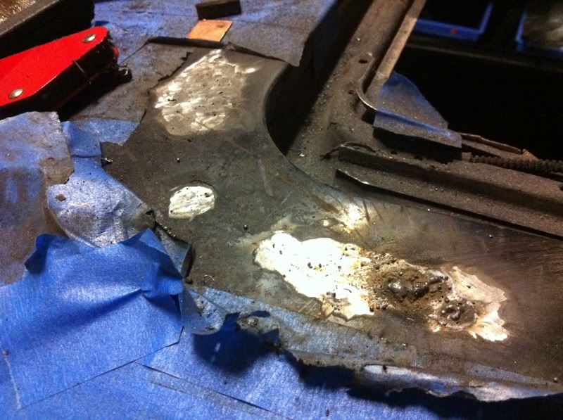

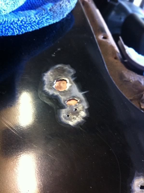

      I started off with a copper plate and some magnets under the roof to give me something to make contact with and something to fill against.

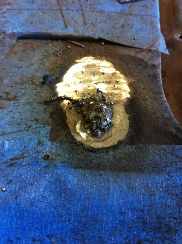

      I added some tape so hot flying slag from messing up the rest of the paint. This was the first pass after the dremel. This took about 10 mins pausing in between to let it cool.

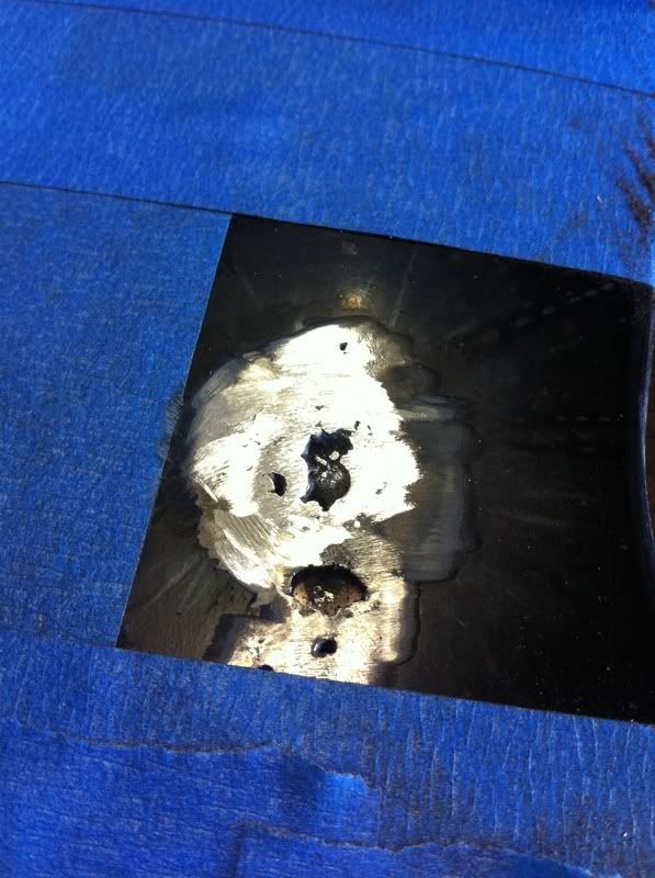

      Second pass:
      Grinded:
      Moved onto the holes below the first ones I worked on:
      And then my dremel died after 5 years of doing things it was never meant for. :/
      So I made a quick run to Home Depot and bought a new one before work to continue tomorrow.

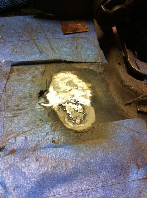

      I say not too bad for my first time trying this. There are a few pits in the areas where I added, but not any that are holes so I'm happy.
      I will say that the pinholes are the hardest as they're so tiny and thin it's difficult to fill them without burning through. I ended up drilling the pinholes a little bigger for easier filling and so the metal is the thickness it is suppose to be.

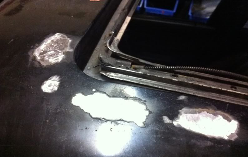

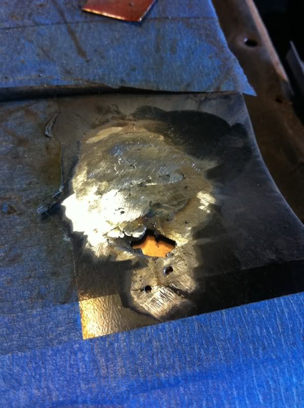

        Almost done welding, one more hole left on the right outside of the pic.

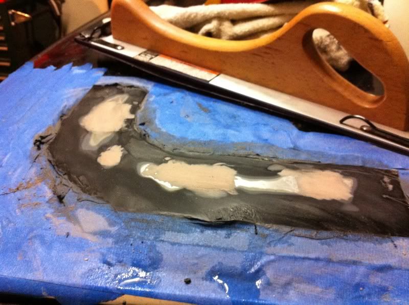

          Finished up the rest of holes today.

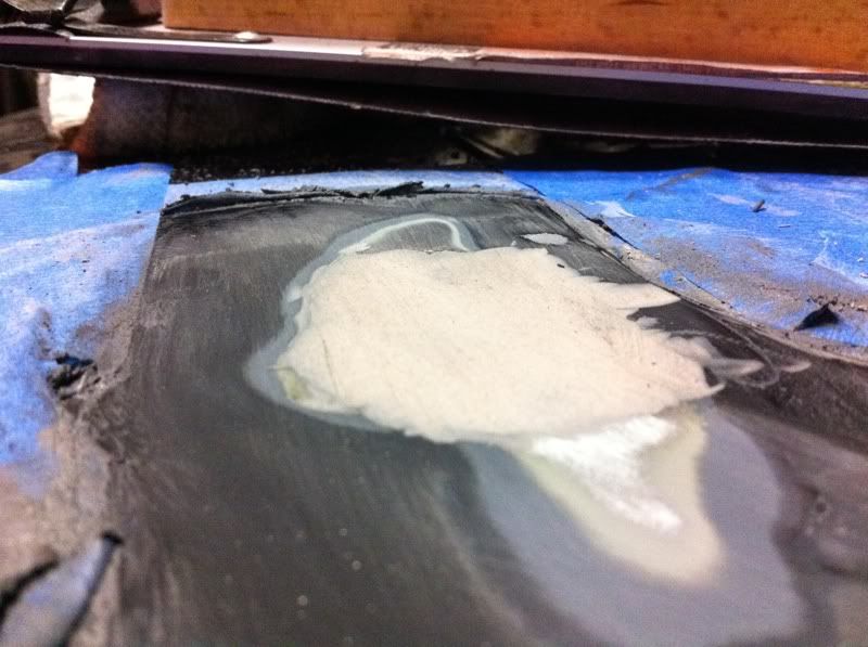

          Smeared some bondo on it so it will be cured for tomorrow to start sanding. And I'm aware that this may be too much, but I rather start with too much and sand it all away then have to reapply a few times to fix some divots. Right now its the same thickness as the paint around it.

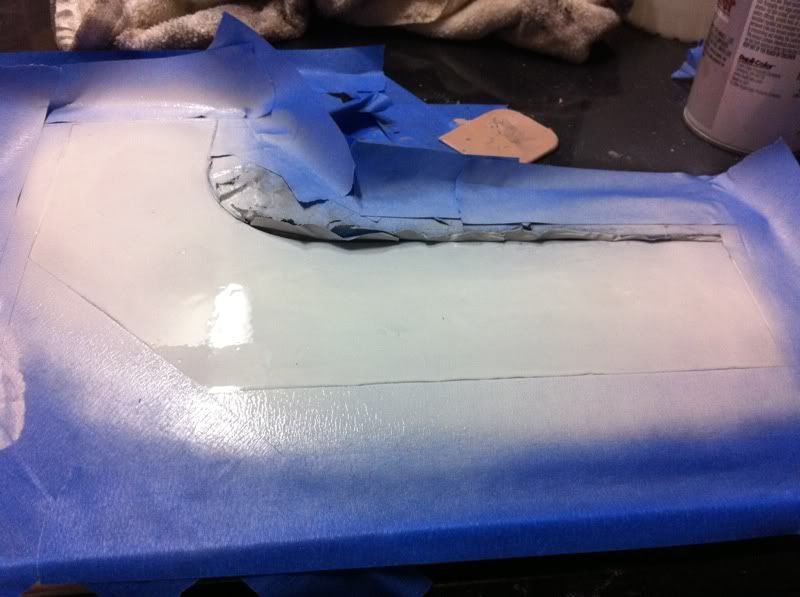

            Here's after the first sanding with the bar sander.
            You can see here how low my welds are.

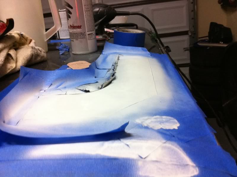

            First primering.

                        Could you show where this pic was taken from farther away?
                        Is that between the drivers side window and the windshield? Or in the back?
                          On driver's side between the sunroof and windshield. If you drop your overhead panel and pull the headliner back you'll see it.
