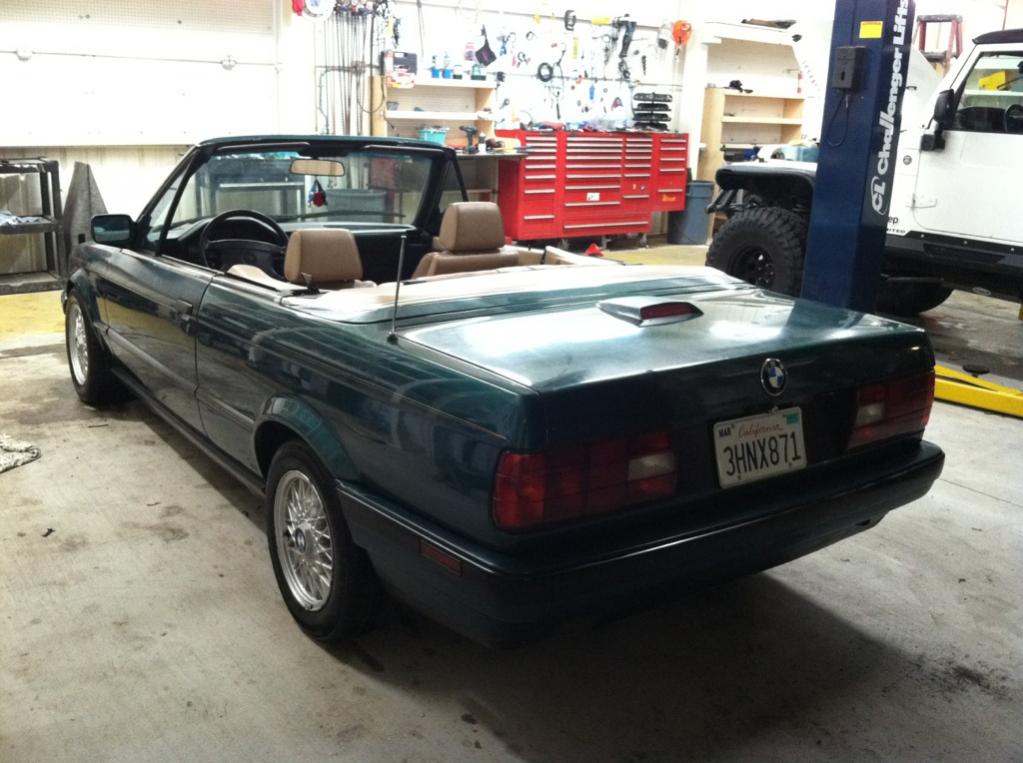

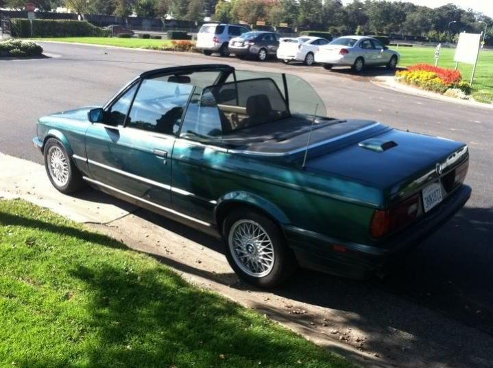

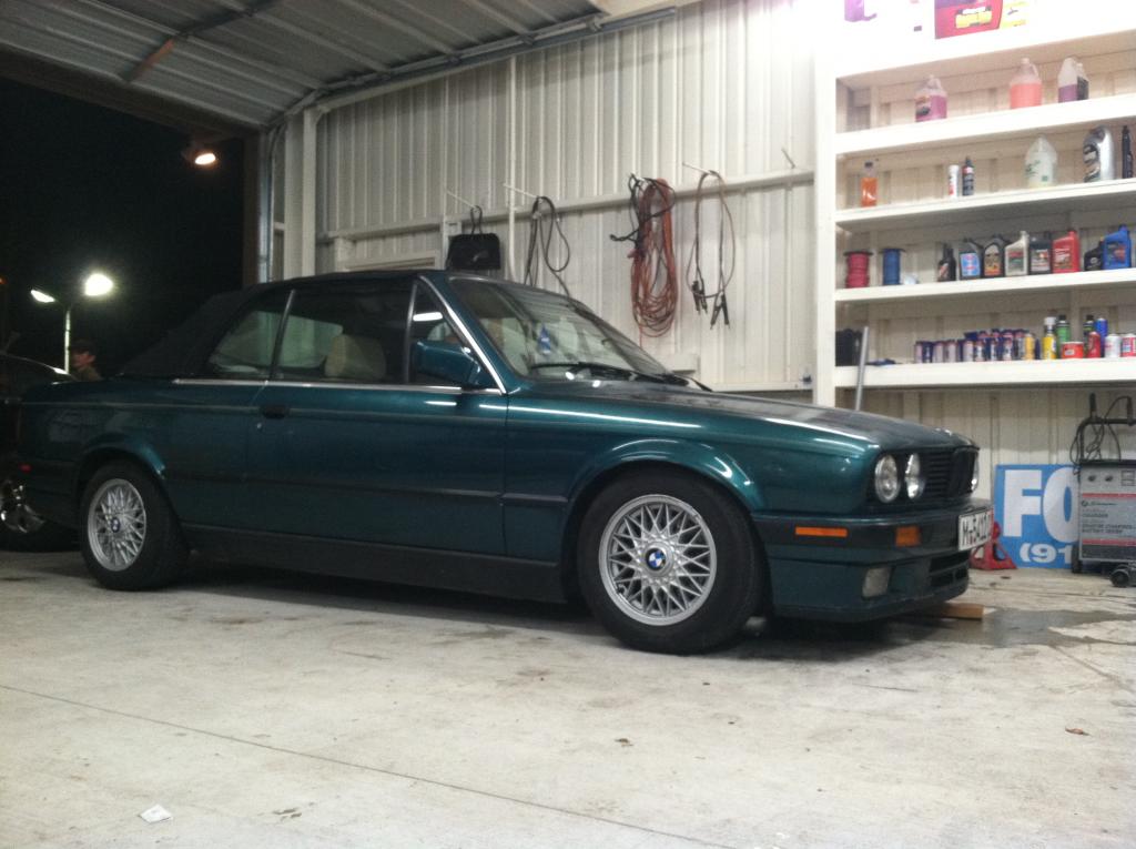

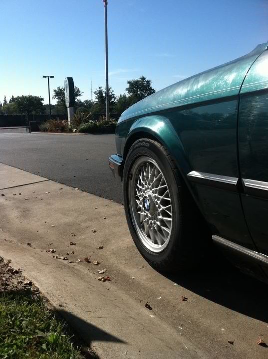

    do you guys think i can get my paint looking like that last edited photo from what my car is now with this product?? http://kustomaccessories.com/3M-3905...B004NDBYQ4.htm

    with the right products, a lot of time and a lot of work its possible. i've seen paint thats shape is more bad than yours. for example my convertible before and after:

                            Base/Clear will NOT have the same results, and as mentioned, there is a good chance you will damage your paint if you just got at it without knowing what you are doing, and that product is not going to produce the kind of results you want. Particularly since those cars are different colors.
                            Spend some time on autopia, or just have a professional look at it. A REAL paint correction pro, not some car wash near your house that offers "details". Most of those produce cars that look like shit with shiny tires.
                            If your clear is peeling (looks like it might be on the top surfaces), I doubt even the best paint correction specialist can help... It'll need to be recleared.
