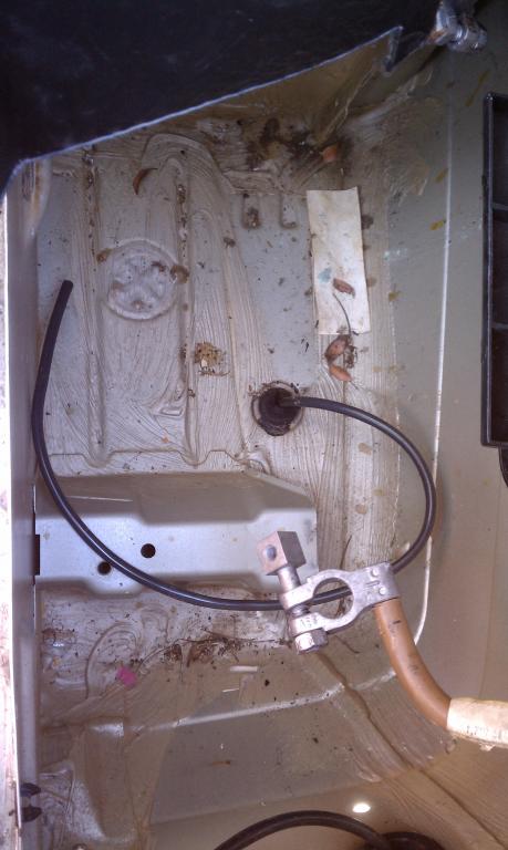

    Drain under the battery tray in trunk?
    So while replacing the battery today, I decided to pull the battery tray out to see what I could find under it. All I found was a drain tube that poked out into the bottom of the well. Where does it connect to? Here's a pic:
  • reelizmpro
    • 9544
    Battery vent
    88 M3 - LACHSSILBER
    89 M3 - ALPINEWEISS II
    • BadCab
      • 80
      Yes, there should be a nipple on your battery to vent gases. Connect the hose to it. If your battery is sealed then i don't think there is a vent.
      • e30serg
        • Dec 2006
        • 562
        Thanks! That worked.
