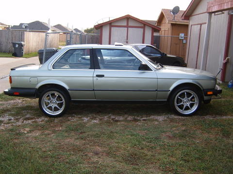

Can I get these bumpers/skirts for my 84 318i?
  • Maluco
    • Oct 2005
    • 6572
    I was wondering if and where I can get these front and back bumper/skirts for my 84 318i? It would look much nicer! The bumpers/skirts I am referring to are like the ones on Digitalwave's ride or the one on the car in the below link. What car is this/year?

    I have a photoshop request regarding this posted in that section titled "PS request? bumpers/skirt " if you guys would like to check it out. Here's a pic of my car. Thanks

    88+ E30's came with the later style front and rear valances
    89+ E30's came with the paintewd plastic bumpers

      I briefly read through the DIY info. It seems like my front end is a little different then what I saw though. So I can use E30 bumpers from 88+?

        If you want to know about the bumper swap, please, read the whole thing
          The front one only.

            Ok I read it. I assume I would finish understanding certain things once I was in the middle of it all... So my question now is, what year bumper/valence can I use? Can I use the bumper on say Eric's 89 325i? Or even the one on your black 327i? Which year would be a better fit or whatever? Thanks

              those bumpers/valences look transform the look of the car, I got to have it! Mine just cuts off in the back...

                The front is a direct swap. The rear is some work. Lots of work.

                  The E30's that came with plastic bumpers are 89 through 91

                    you will need front and rear plastic bumpers from '89 and up.
                    also you will need the front valence (under the bumper) from '88 and up.
