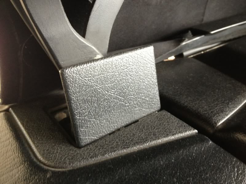

    I've ordered new top caps (the black flaps that raise when the top is up and lay flat when the top is down) but am unsure how to install them. I'm assuming I remove the back seat, then the side panel trim, then the side panels. From there I am lost.

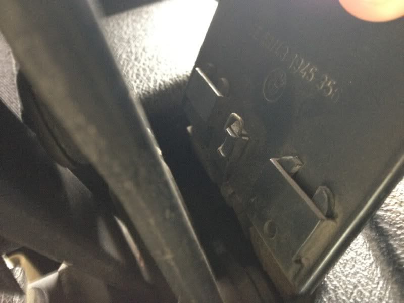

                    I just replaced both of these on my Cabrio. They are held in by 3 spring clips per side. Remove the seat bottom & speaker cover, then the screws underneath it that hold it to the body, remove the verticle portion of door weather strip and slide the whole panel out.
                    Gently pry out the spring clips, then slide the old plastic piece forward. You do have to spread the plastic slightly on the new one to get it started so dont break it.
                    Took me 10 min from start to finish and that included removing 23 years of grunge.
                    51-43-1-945-355 $15.xx
                    51-43-1-945-356 $16.12
                    Yes its #14 and you get the flap and surround with a new spring.
                    NOTE...these PN's are for a manual top only.

                        Semi-fixed. I had an extra flap but the tabs of the old flap had broken off in the housing. I was able to get them out with large curved needle-nosed pliers and install the flap. The housing has no spring and the lower tab against which it rested had broken off. So it still has no spring and lifts up at highway speed. I'll get the right parts and do it right in a couple of weeks when I get back for Austin. I also installed new support struts for the top lid. That was pretty easy.
