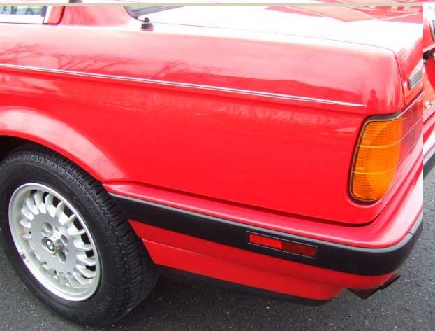

    im moching up my plastic bumpers on my 89 vert and the arches are different. from everything i have read plastics are supposed to be a direct bolt over. am i missing something here? should i just keep tinkering with it until i find the right fitment?
    Sorry for the large pic size. Photobucket is being lame right now
    oh, and looking at verts i noticed on the coupes that the crease where the bumper goes continues into the wheel arch, whereas on my vert, it kind of just fades away, so its creating a gap between bumper and body.
    i did slot the bumper shock mounting holes and bumper shock slip, FYI
    gap
    arch difference
    other side
    Help Help Help

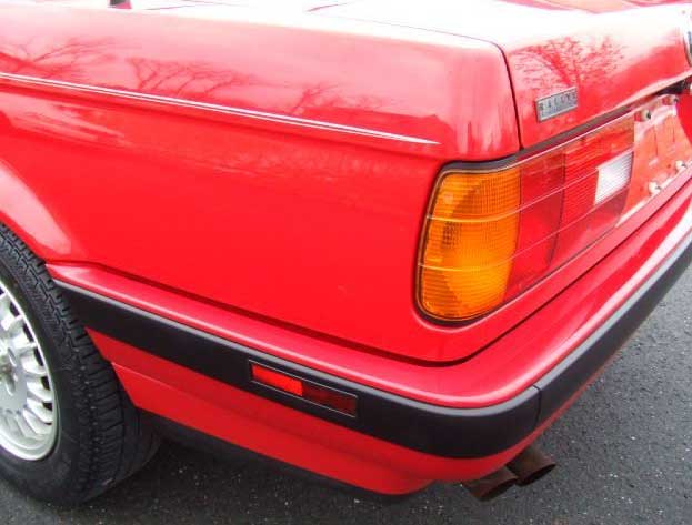

          I think you need to play around with the placement some more. Looks to me like it's mounted too high or perhaps it's not level and it's tilted up where it meets the fender.
          Here's some pics I saved from a mint ~30k mile e30 on ebay awhile ago. This should be a good representation of what the bumper gap should be from factory:

            ^^ but thats a sedan..not a vert for comparison...
            in the OPs pix, you can see the rear arches being longer and traveling all the way down, whereas the sedans arches are bent and molded around the bumper (or where the bumper resides)

              He's trying to replicate the fitment of his bumper to the one from a plastic bumpered car and that's what my pics are there to illustrate. It doesn't matter if it's a late model, plastic bumpered vert or sedan. They're the same as far as the bumper fitment goes.
              Comparing the pics it looks like he has his bumper mounted too high and the gaps are too tight. While it may seem counter intuitive there are supposed to be a bit of a gap between the bumper and body.

                Thanks for the help guys I really appreciate it. The gapping makes sense now. I definitely have it tucked up tight in the pics. The thing that is getting me now is that on the late model cars the seat/crease for the bumper continues into the wheel arch whereas on my vert it stops at wheel arch. So when I put the bumper flush with the arch it creates bigger gap right at the transition to the arch.

                  you need to grind away those guides on the bumper otherwise they'll interfere and give you the problems you're experiencing.
                  Like this:
                  Note: This is a shortened bumper I modified for an early model but the principle is the same. You can see how I sanded down the guides on the bumper otherwise they interfere.
