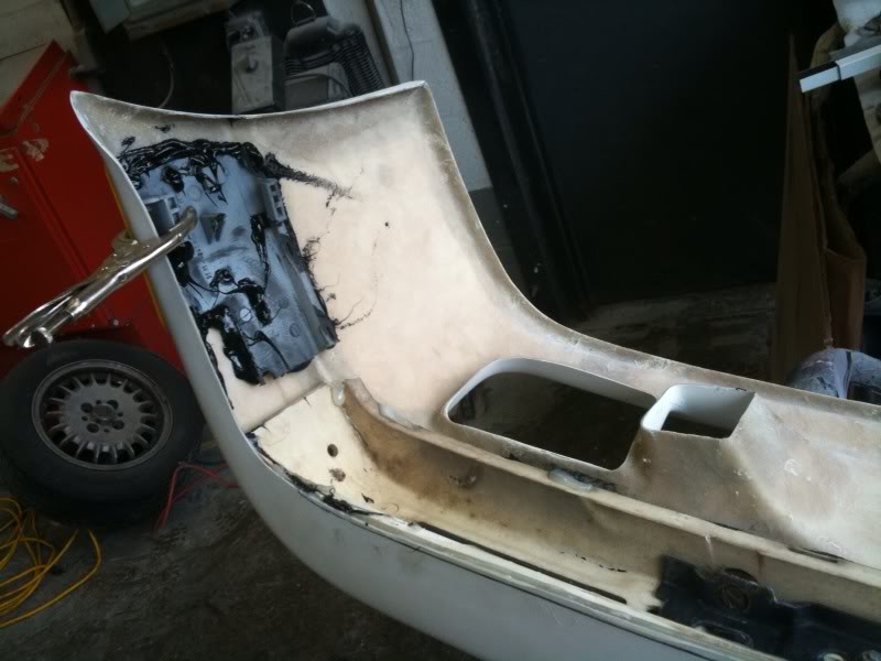

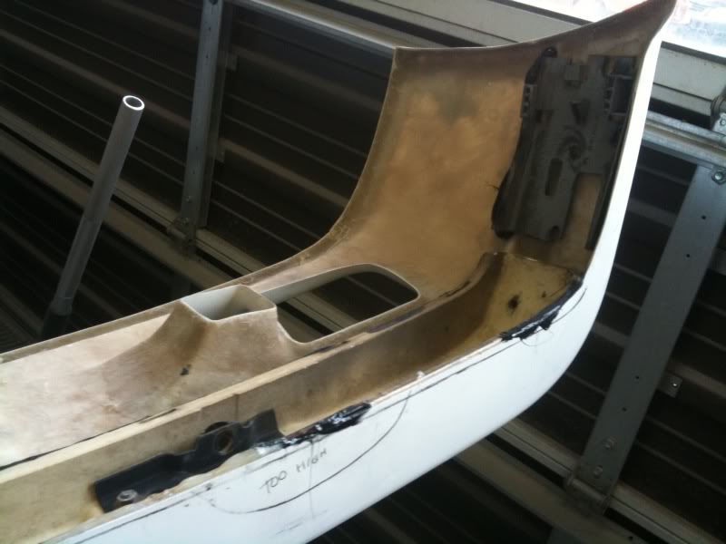

                        The problem you're running into is one of the main reasons most people recommend against buying replica kits. The hassle of making mounts or doing custom work kind of negates any savings over the real deal genuine BMW parts, which really don't cost all that much more.
                        That said, probably the best way to make the fiberglass bumper work is to mount it in a way that's as close to OEM as possible. That way you can use OEM bumper shocks with it, and the side brackets. It'll take a lot of the guess work out of it.
                        You'll want to get a cheap OEM front plastic bumper that you can use for parts. You'll need the inner bumper reinforcement and also need to remove the guides which are plastic welded to the bumper skin. You just grind down the plastic welds that hold the guides in and you can remove them from the bumper skin.
                        Here's some pics from one of Vlad's old threads. If you're going to do it then this I'd say is most proper way to mount a fiberglass bumper.
                        You'll find more info in the thread here: http://www.r3vlimited.com/board/showthread.php?t=182981
