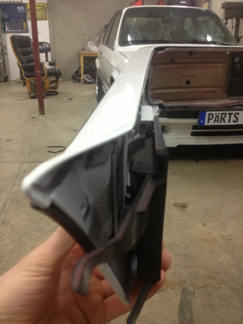

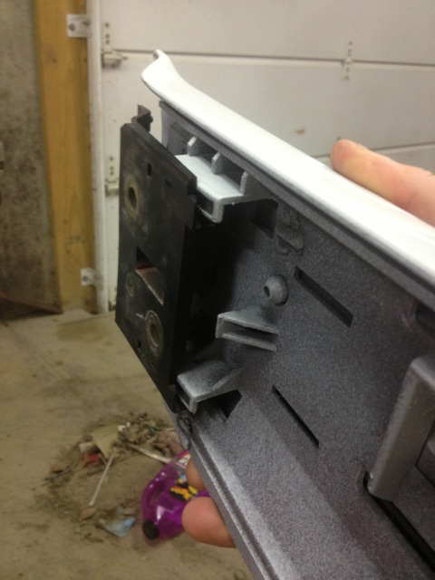

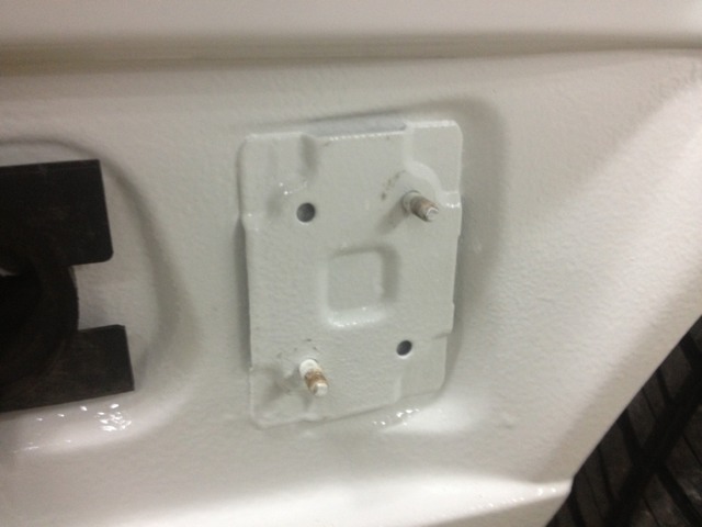

    Ok so I'm trying to put plastic bumpers on my 88 and i've always heard it was a direct bolt on but the rear bumper doesn't sit right on the sides. There's a huge gap between the bumper and the body.Click image for larger version

    Do I have something wrong? The bumper does slide into those brackets but it still sits out to far.

    Make sure the bumper itself, has a plastic bracket that bites the one on the body and interlocks the 2 of them. It's easier with 2 people doing it, as it can be a pain to guide and slide into place by yoursel but you're almost there dude., good luck.

      Do you have the brackets on the bumper?
      If you do, it looks like you aren't threading/sliding them into the support bracket on the body.

        ya the bumper has tabs on it and they seam to slide into and lock in place very nice but it seams like the piece on the body sits out to far, i wouldn't think it would matter because its an IX. I.m almost thinking of making some custom brackets but I've never heard of that needing to be done.

          How does the other side fit? They should go in at the same time and straighten everything out.

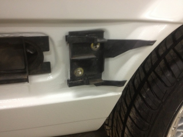

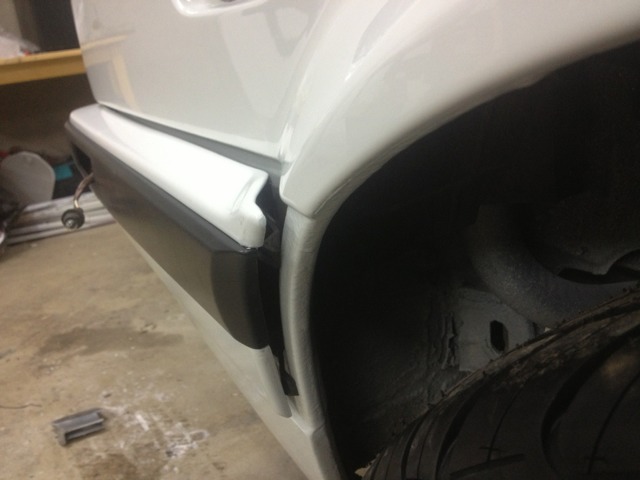

            Here's a few other pics to show what I'm talking about. And both sides do the same thing Click image for larger version

            In these pictures your can tell there's like a 1/2 inch gap from the back of the bracket that would go up against the car and where the edge of the bumper is.
            At the back of the bumper it fits great just pushes out by the wheel well.

              Those brackets have adjustment..try pushing them up as far as they go,on the body and tighten down.

                  on the pics above,see those 2 bolts out on that plate,you have to take the plates out and drill a hole for the plastic bracket,thats why your bumper has a gap

                    Dont follow that advice. You have an 88, you keep those plates attached to the body. Don't cut them off or modify them
                    You just need to keep playing with the adjustment, perhaps loosen the nuts that hold the bumper shocks to the body as well so they have some freedom to move

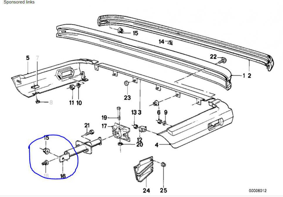

                            How does one get the rear diving board bumper and trim (88) off? The front was easy . I was able to get the shock mount nuts off but the whole thing seems to be tight as a drum. Are there side bolts under the trim that I can't see?
                            Discounts to all R3VLimited users on Amsoil products www.tampabaysynthetics.com
                            • Don Stevens
                              • Aug 2007
                              • 372
                              All
                              I solved my own problem. Posting a reply here so more guys do not make the same mistake I did.
                              The following image for Real OEM saved the day. I had no idea there was a bolt holding the inside of the bumper shock to the frame rail (circled on clip). The passenger side was a snap to get out once I located it. The driver's side was up under the muffler and heat shield so it was bit of a bitch. Lot's of cussing an scraped fingers but is finally out.
                              Now on to swapping to plastic.
