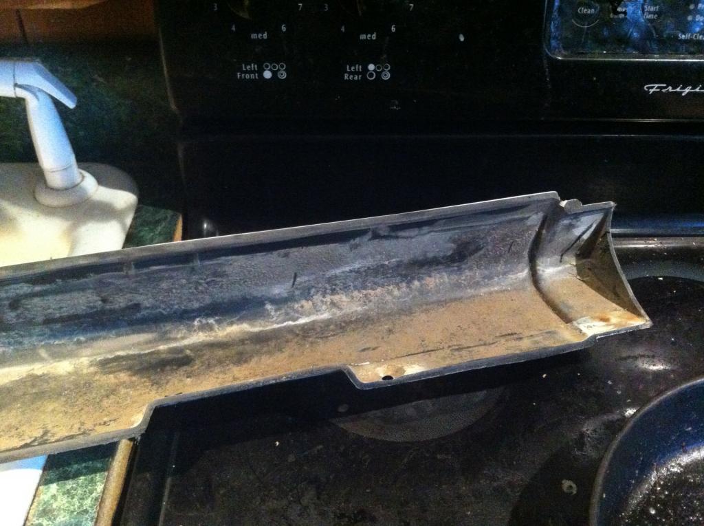

    First, I took my jig-saw and cut off a large portion of the bottoms and tops of the skirts so it looked like this:

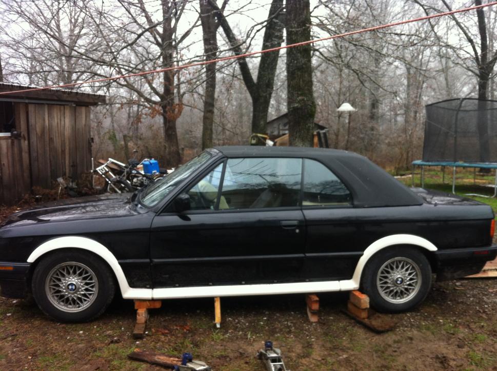

    Then I cut a similar amount off the flares where they would contact the rockers. Then I used a bit of regular strength double sided sticky tape and bricks to mock it up on the car.

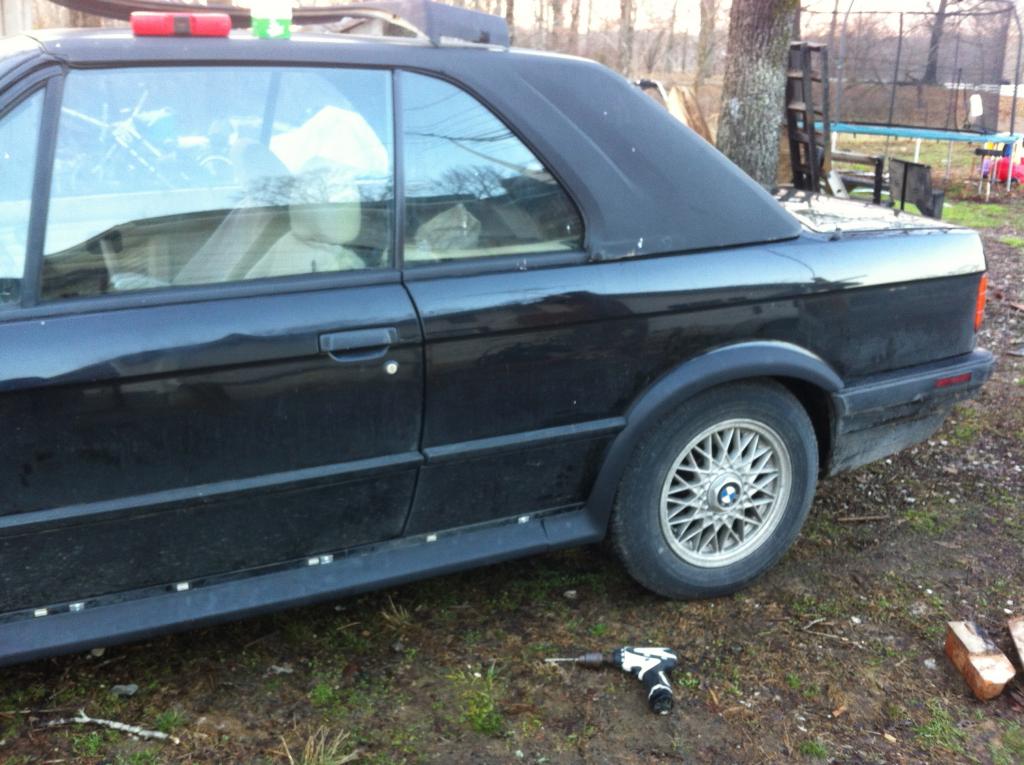

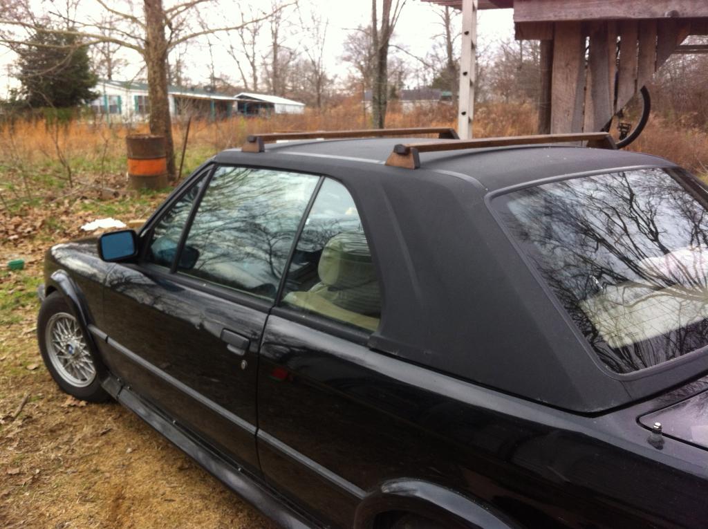

          Then I purchased some of the super ultra sticky double-sided tape from the auto parts store to help stick the flares to the wheel-wells cause I didnt wanna drill holes in the outside of my fenders. Again, if for whatever reason I wanted to go back to original, it would not be ruined. But as you'll notice, there's no reason for that...
          Bam! Whaddaya think?

                  Now, to your addition. Do you have additional pix? I'm curious to see how much of the lower cabrio panel is exposed. This looks like a good option for a black cabrio. More angles pix and a wash/detail would be nice too. Nice work and thanks for sharing.
                  COTM
                  • Ether-D
                    • Sep 2011
                    • 2838
                    I did wash her up after this, but it's winter, and you know how long that lasts...
                    The lower panel is visible in that last pic. It's a good 1 1/2" lower than the bottom of the skirt. But it's hardly noticeable IMO. I'll see if I can get a cleanish pic up...
