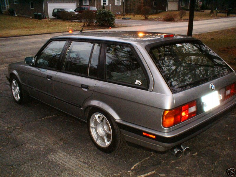

bodywork guru question on fitting this roof wing

    can fit which is why i made this post. im not asking nor care if you think its ricer or not.

      Oliver's method of making the wing out of fiberglass would be best, but if you don't have that ability you could conceivably trim out the center until the leading edge matches the curve of the roof...then you would have to bond it effectively.

        What is it made out of? Is it flexible enough that you could make it fit by pressing down on it?
          trying to figure out how to trim it to get the curve of the window. cant see how i can make a template
          i got the idea after looking at the wagons.
            Do it in steps and continue holding it up to the window to see what needs removal next.

              Start from the middle and make your way to the edges, good luck.

                Any updates on progress? If you decide to start working with plastic or fiber glass you could also consider pro - grade auto body glue. Do you ever come to the Boston area?

                  ebay... also for the one you have i have seen windsheilds with a hole for an antenna. So if it has mounting tabs have a glass place drill holes in the glass then mount it but will you still have the contour issue. i would go with the ebay one.

                    dont like the ebay one, to big and flat
                      going to heat it up and bend it 1st and see what to trim later on today when i get home. never been out to boston.

                        so far had to cut in 3 sections. i got both corners trimmed and had to use my heatgun.
                        now i have to trim the back of the middle part then i can weld the 3 parts sometime this week.

                          Wait...weld? What are you going to use?

                            plastic welding to make the 3 peices whole.
                            i always just use the old plastic that was trimmed off with my old soldering iron
                            link if anyone want to know about plastic welding
