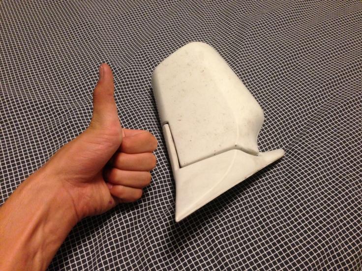

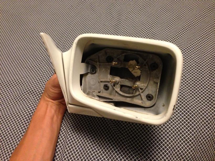

    I want to try my luck and repaint my alpinweiB II mirrors as professionally as possible, I got all the supplies including some quality color-matched aerosol paint.
    if it goes well enough, I'll post up a quality write-up for others to try it out. the goal is to treat this repaint as professionally as possible, so what should I know bodywork gurus?
    • is it fine to sand down to the bare plastic/aluminum mirror base?
    • how many coats should I do?
    • what kind of can motion is good for painting an item like a mirror?
    • do I need primer?
    • do I need acetone/wax remover/tack cloth?
    • if I do need primer, what grit do I sand the primer to?
    • should I stay away from grits above 400 so that the paint has some texture to stick to?
    ATM I can't afford to repaint my mirrors @ a shop/learn how to do with with HLVP but I sure as hell am capable of learning and have an eye for craftsmanship :-D
    thanks! btw I'm new here.
