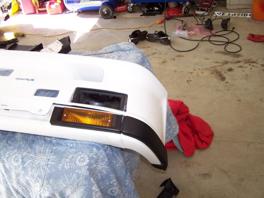

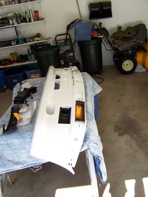

            Ok. It looks like the fog housing/body fits right into the valance.
            84 325e Burgundrot S52 M Tech 1.
            http://www.r3vlimited.com/board/showthread.php?t=250109
            • GT BMW E30
              • Nov 2008
              • 2491
              I sent you pics a long time ago. The euro fog blanks fit to the euro valance only. The fog bracket notches fit into each side. Then it is bolted into the valance with one bolt. If your using US valance you will have to modify the valance for the fog bracket.

                  Brad the fog brackets have those pins on them and they slide into the holes in the MT1 valance. I think I have a set of brackets I can send you if you need them. just pay the shipping
                  EDIT: just noticed your last pic. I guess that's not your MT1... the fog pins snap right into the MT1 spoiler. don't your E30 M3 fogs have those pins on them? I thought they were identical to the MT1 and euro fog lights.
                  Pic from Levent's website last year
                  so what's your plan on the valance? if you're not buying the 772 you can mod a US early model one but it requires modification as Damian / GT BMW E30 says.. there some good info here on e30tech though it's not really MT1 specific. your metal valance will be sitting behind the MT1 spoiler and not visible so that gives you options.
                  Check out this post from fporro it shows several different front panels. you can also check out that front panel and valance post I put up for front panel comparisons
                  still waiting on my 772 front panel - ordered it 6 weeks ago
