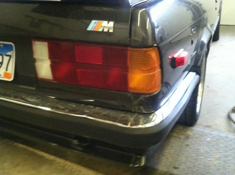

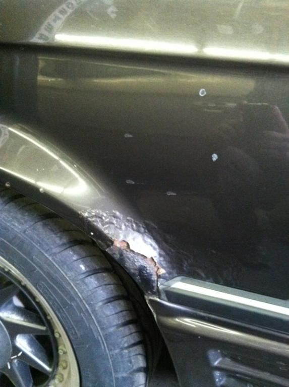

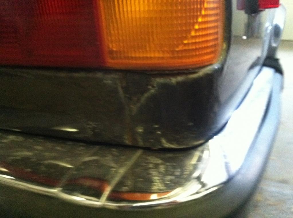

    Bought a e30 with intentions of doing a m5x swap. Before I do the swap I want to make sure the body is in good condition so it calls for some rust repair:(. My question is from a stand point of having 0 body work experience how hard would it be to repair the rust on this car? As far as I know and until I strip her down the rust has be contained to the right rear on the wheel arch and just under the tail light. To repair this do I need to fab ne panels or will so bondo and a quick re spray fix my problem?

    You need to cut the bad metal out and weld in new. Not something someone with no experience can do. Best to have a body shop do it.

                  Bondo is design for MINOR dent repair, not covering up rusted panels. If you don't get rid of all the rust, it will come back and bubble up through the paint.

                              Just a update i got to work on the car and started taking the body kit on only to find out I need a new Quarter panel and rocker panel, it also looks like I'm going to need some of the passenger side trunk floor.
