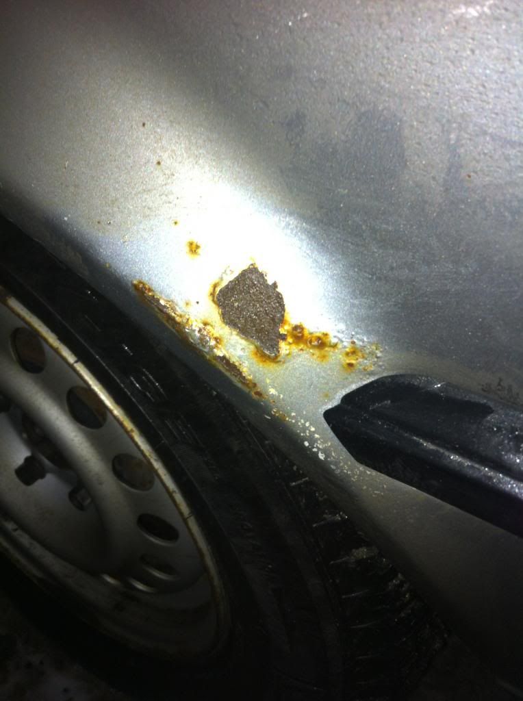

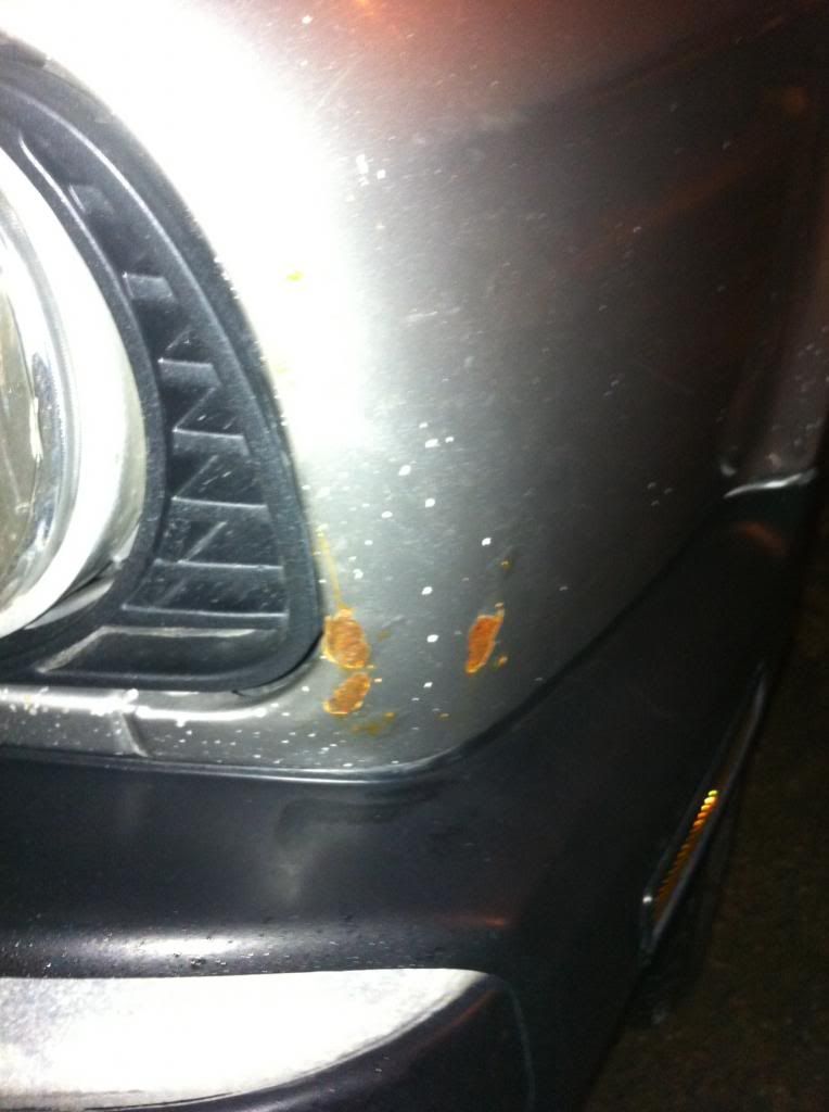

    Here's some cell pics of the worst spots:

      Sand the rust spots down to the bare metal, then primer and rustoleum. Wouldn't waste your money on por-15, I remember seeing something on hotrod.com or one of those restoration websites about how you've got to get the metal clean to have lasting results with it... besides, that's a kinda expensive chassis paint, not really meant for body stuff.
      • Sea Aych
        • Apr 2013
        • 767
        yup, those seem to be in places (mostly) where a bit of paint lines from your new spray won't be too too noticeable (in the door area, and on corners).
        For rock chips you could stick some sandpaper on the eraser of a pencil and grind it away and use some touchup paint (or drcolorchip if you can get it shipped up from the us for a reasonable price). I know i'm going to be doing a lot of this when the snow melts over here!
