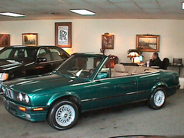

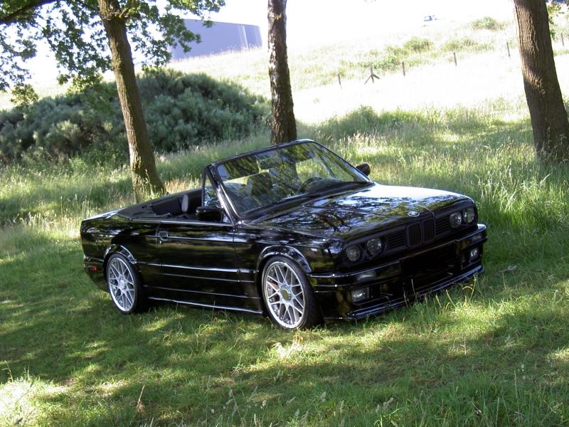

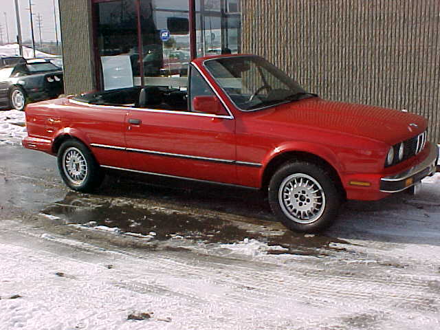

              mt2 rear too, see pic of my Delphin cabrio and plastic bumper swap with Racing Dynamics on the Red one.
              m tech 2 bumper it's actually same thing as a plastic bumper but without the black rubber mustach (or so i call it), see first pic.
              here's an m tech 2 set up i removed a few days ago.
              rear bumper and apron skin are 1 piece, front bumper separates from spoiler.
              what you'll need it's a late syle valance to attach fog lights too, then the mt2 spoiler clips onto it., see picture with Red valance (from plastic bumpered car) and Silver mt2 spoiler.
              Save the rubber strip under your valance, it will fit onto late style valance with very minor mods (screws)
              last pic shows early valance with late style plastic bumper.
