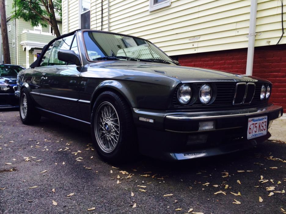

    Hi All,
    I have an early model 1987 e30 convertible with US spec metal bumpers. I've been looking for a rear apron, but haven't had much luck finding something that will fit. I see the MTech apron requires the Euro metal bumper, for example.
    Does anyone have a suggestion on what apron I could fit on my car, and where I could buy it?
    Attached is a pic of my car as it is today. I'm going to spray and tuck the bumpers, and also replace the license plate holder with the rubber strip insert.
    Thanks for the help,
    Dave

    Not many options, and the ones that are out there are mostly fiberglass. for rear apron options you really need either plastic bumpers or euro bumpers.
