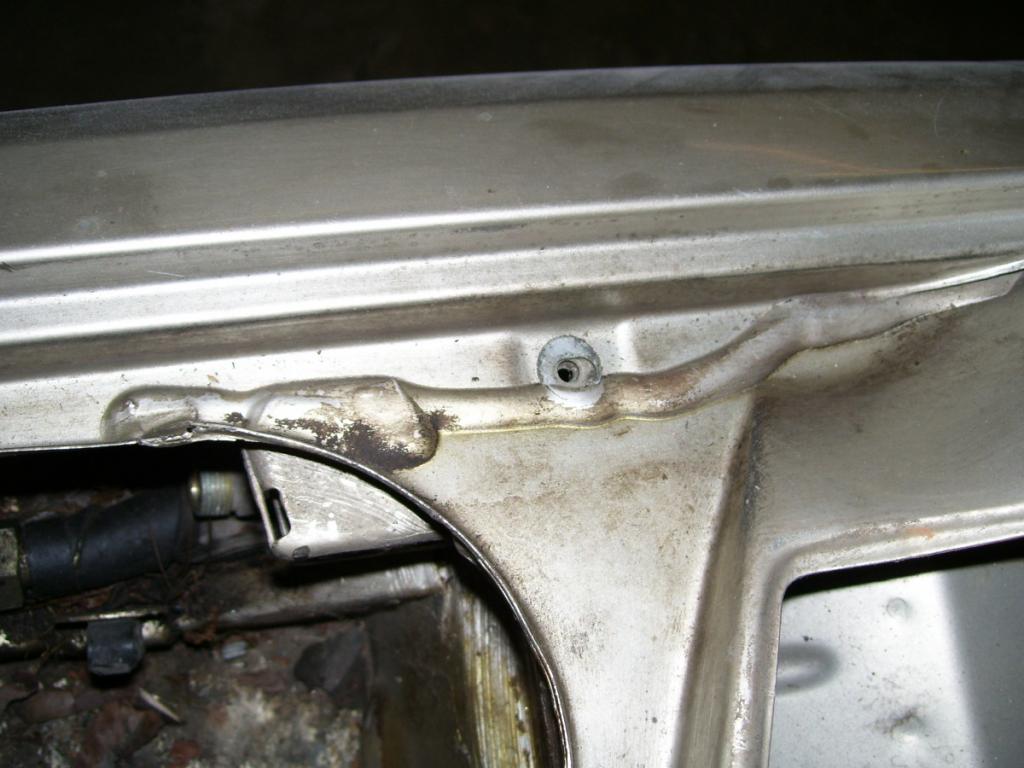

                Yes stiffening rib and the fenders that I removed from the early model E30 had factory seam sealer at the A pillar base to fender junction (I have never seen a repair that look like the factory applied sealer).

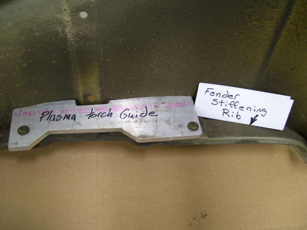

                Photo of fender stiffening rib and plasma torch guide used to modify early E30 fender. The early fender notch is very shallow and needed to be about 5/16" for the fender to fit my '87 properly. The plasma torch would remove nothing from this late model fender.

                  according to realoem they are the same. if someone could verify either way that would be helpful as i am going ot be buying a fender soon and only have access to early models and i have a late model.
                  • KMOSES
                    • 591
                    Just look at the fender above. If the notch on your fender at this location is 1/4 - 5/16 inch deep you are good, if it looks like it is almost straight across, break out the Dremmal cutoff disk! A little trimming is all that is needed to make it fit. My point is at one time I think the fenders were different on early E30s.
