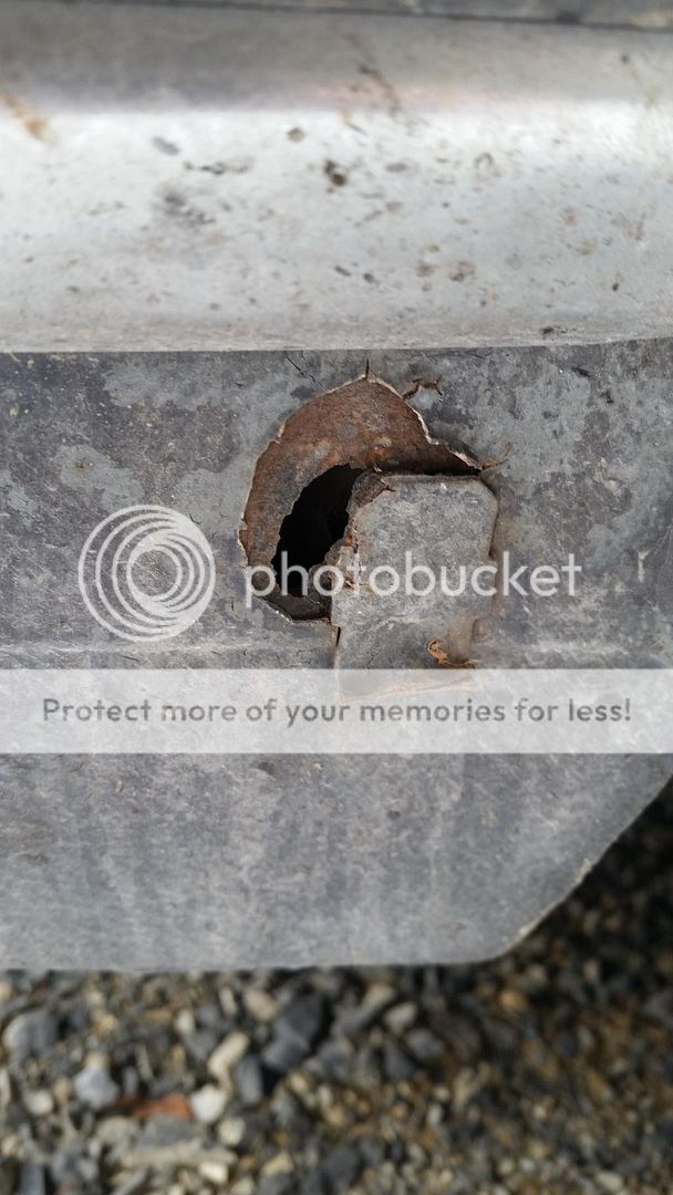

                        Here are a few pics of the issues on my car. There is also a bit of rust at the rear of the front wheelwell near where the fender bolts up. I'm going to cut that out and make a patch, not an issue.
                        That picture is by the tab on the rear valance where the factory US bumper trim attached. I've installed Euro bumpers so my plan is to cut the tab off, cut out the small amount of rot and weld in a small patch.

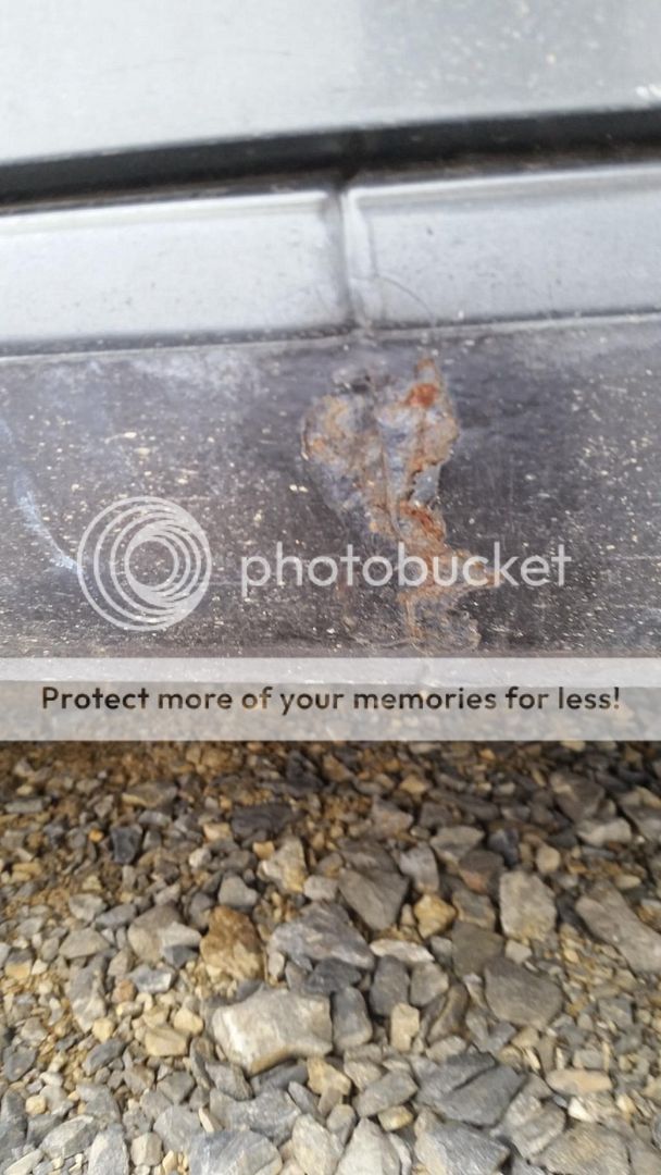

                        This is the one that makes me nervous. It's the seam under the door on the driverside. I'm happy to cut out rotted metal on a flat, non butted area but this is a whole new ballgame. Any insight?
                        When I restored VW bugs when I was younger, before welding in new metal, I'd spray the cleaned area with a primer that is high in Zinc. You can weld right through a Zinc primer and it galvanizes the area to prevent further rusting from the repair. Usually the issue is that it will rust from the inside out.
