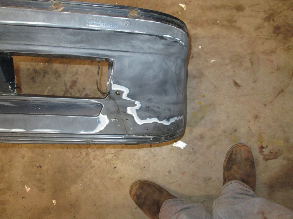

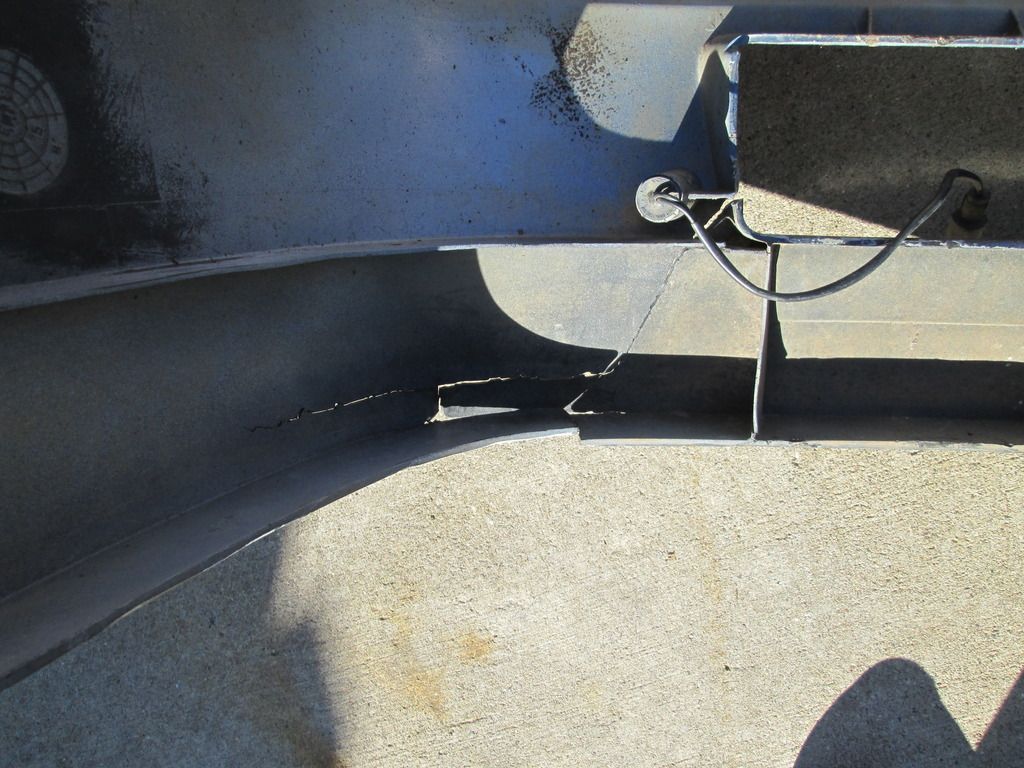

    I'm working on a m635 front spoiler and trying to figure out the best way to repair a crack before I paint it.
    My first thought was to get some strong adhesive like JB Weld- plastic bonder and glue a piece to the back side of the crack and bevel the front side and fill with body filler.
    Somebody else recommended plastic welding it. I've not done that before but wouldn't be against it if it would be stronger than a patch on the back side.
    Thoughts?

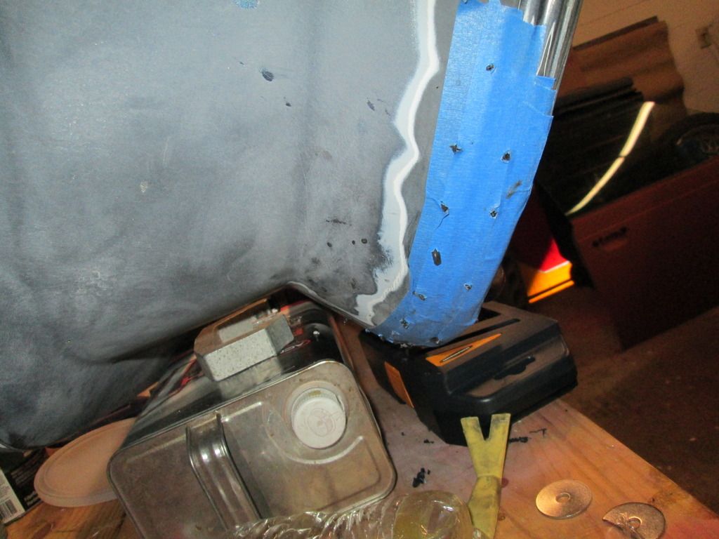

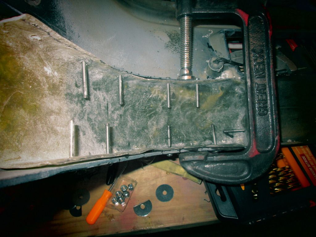

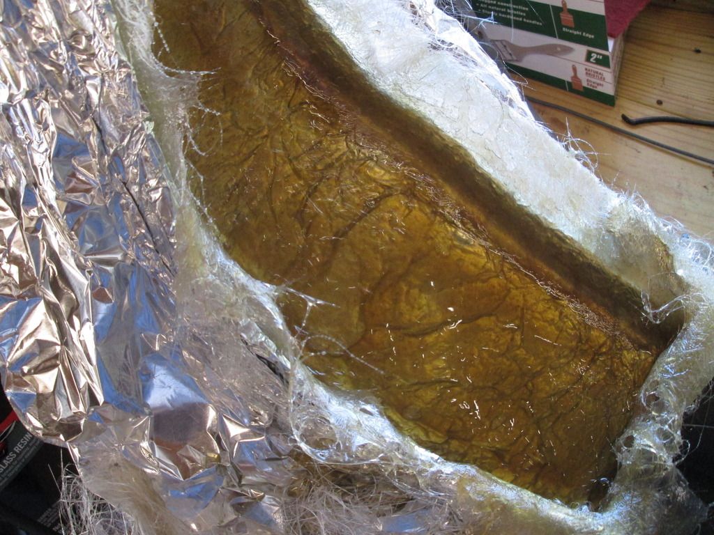

                  So it turns out the spoiler is made from Elastogran, it's a thermoset plastic. It's not really a worthwhile endeavor to weld it, it just wouldn't be strong. I spoke with the national training manager for U-pol and they recommended using their 7061 product. It's a fiber filled filler specifically for plastic. They wanted me to drill holes, and use a mesh sheet on the back side for re-enforcement. The stuff isn't cheap, about $35 for 2 pounds. I took it upon myself to incorporate a molded piece of fiberglass for extra bracing. It's really secure and the U-pol filler worked great.
