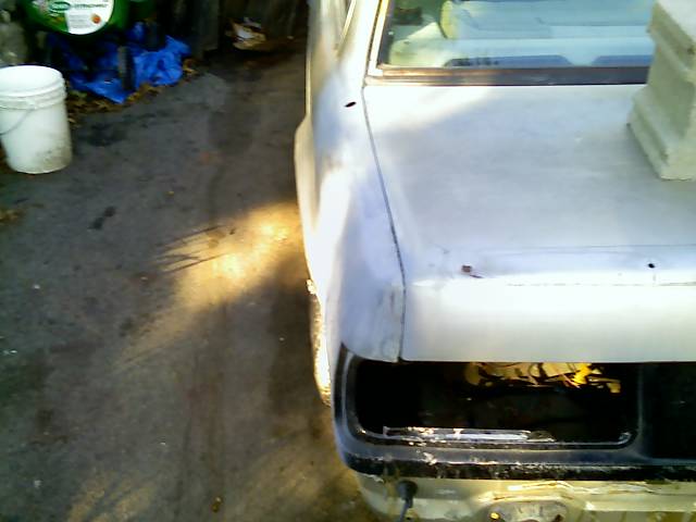

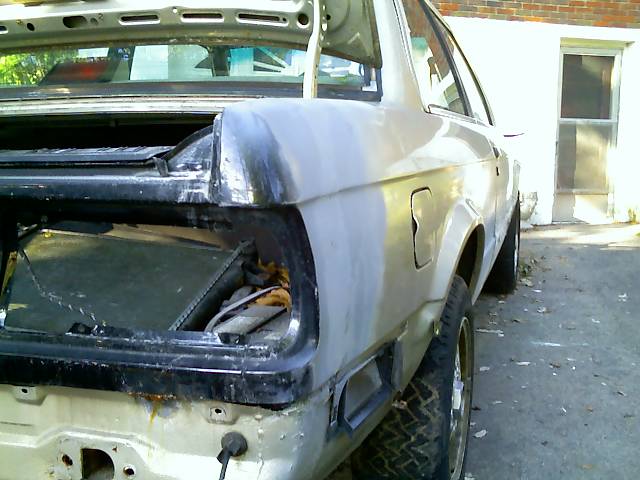

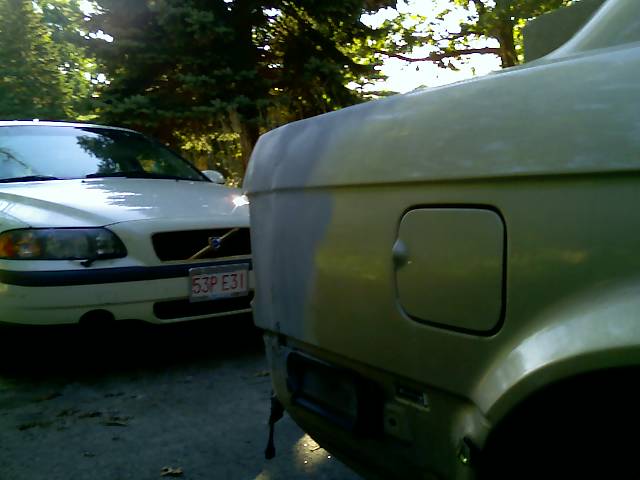

            Here are a few pics, again, not completly done yet. I still need to work on the contour of the line on the passenger side, sinc eits def still off. This was just 1st sanding with fiberglass filler.

              Looks a lot better now. How far are you from Framingham?
