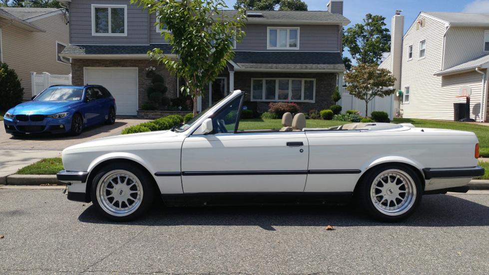

    early vert w\ euros
    I have an early vert with euro bumpers.
    What are my options for front and rear valance. I would like fogs for the front and the rear looks unfinished.
    Any help is appriciated. I see so much on plastic bumpers and such but maybe not many of us going the euro direction?
    Thanks

    an OEM euro valence for the front and a stock lip will get you everything you need.

      would I only need the valance and the lip? is there any other parts for mounting I will need?
      how about for the rear?
      Any recommendations on where I can source?

        Do my end caps line up properly?
        are your converts from US? did you have all the holes left behind welded?

          those are some verts I found online. I have a euro coupe, but it's been on jackstands for a while.
          your caps seem fine, maybe the rear one needs to be tweaked a bit to sit straight but that's it.
          what you need is a '86-'87 euro valence and some foglights with their holders, part #8 here and 2x of this stuff.
          it might be hard to find a 770 valence in the states, there have been some supply issues recently and people have been getting incorrect valences. verify that the valence is the correct one before paying, if you find one.
          edit: the thread you just posted in is the valence you need yup

              Your rear end caps are off. The verts used a different one than the coupes/sedans.
              Pull them and check the part #s.
              They should be 51121937413 and 51121937414
